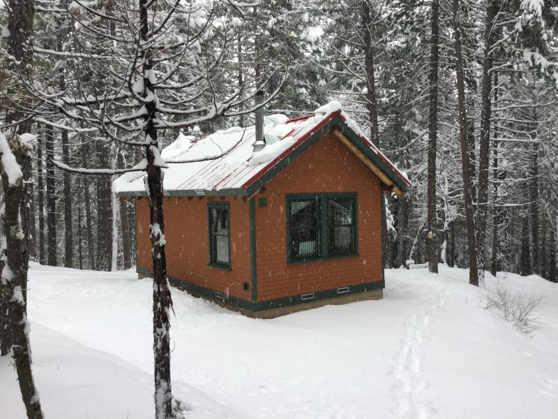

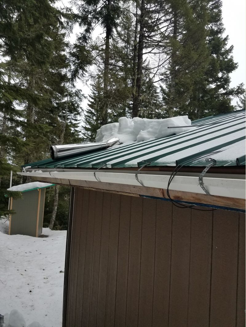

Hello, I'm looking for suggestions from people who may have had this problem. We bought a small cabin last spring. It was missing the stove pipe above the roof, we had assumed it was from a wind storm. after an unusually snowy winter a build up of 3 to 4 feet of snow took out the new stove pipe. Unfortunately the person who built the cabin had the wood stove built under the low side of the roof.
I'm now debating running the pipe out the side of the cabin or doing some roof modifications to keep the snow from building up against the chimney.

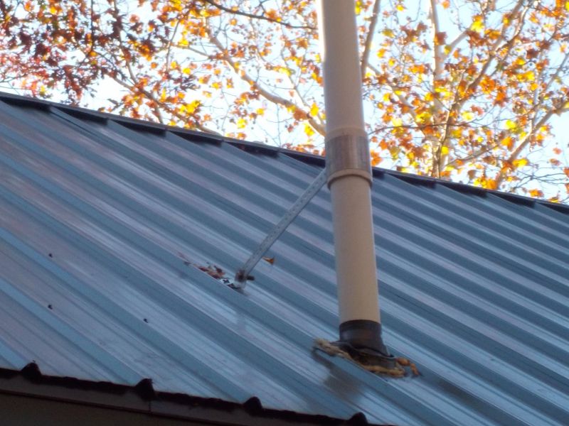

I installed a snow deflector above my chimney. Mine is basically a wedge that is about 2 foot high. When the snow slides it splits on the wedge and leaves the chimney behind. I will look and see if I have any pics of it.

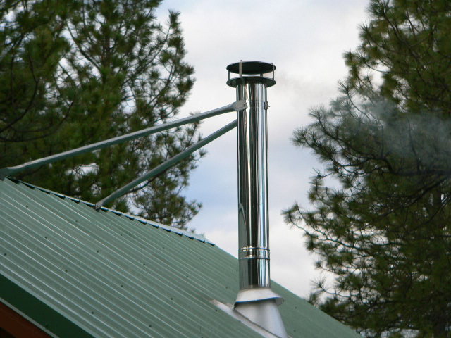

Easy fix, the installer instaleld mine w ith large support pipes. Galvanized conduit pinched flat at the ends, achored on the pipe and the roof near the top. here is a sno-jack also, this is basically a gusset/support that will slice the snow if ti slides also, there is brackets you can put up there that will hold the snow in place. I like to slide it off, so the snow jack is the ticket.
He used 1/4" metal conduit, pinched at the ends flat, holes drilled, then another section 1" and it slides into the other to make them adjustable in length, then a jamb bolt is welded where they overlap and its tightened.
I have never had an issue at all. He said I wouldnt. He has been installing these over there is big snow country for years.

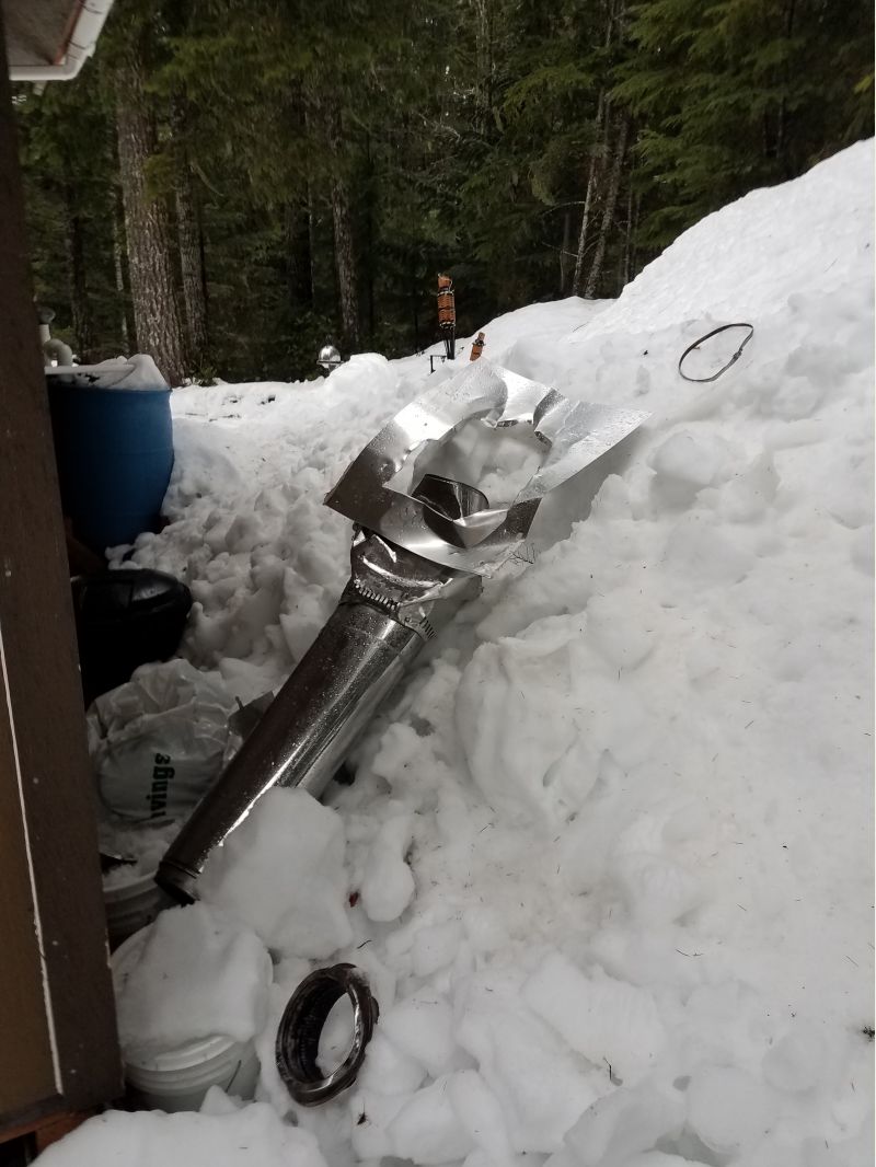

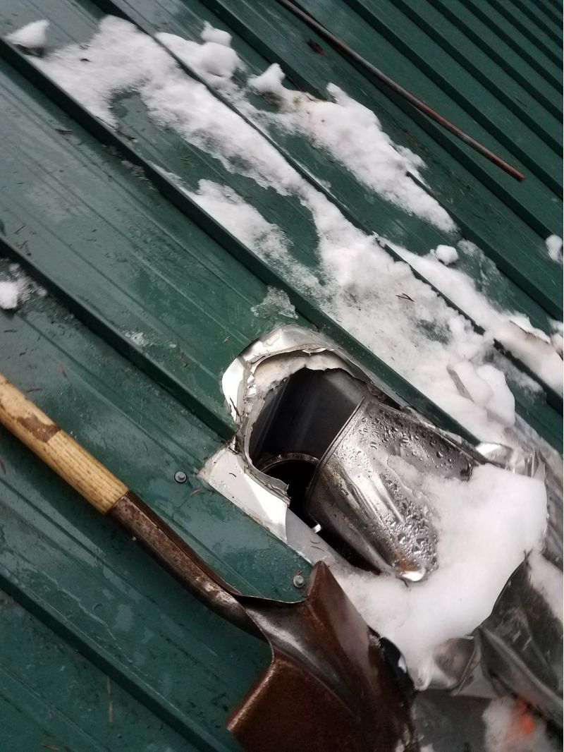

Thanks everyone. I will probably go with a combination of the snow wedge and bracing. After seeing the power of what the snow did I'm all for overkill. It ripped apart the welds on the stainless steel flashing and crumpled the double walled stainless pipe.

Snow splitter and bracing. The splitter was available from the chimney manufacturer, in this case DuraVent, as was the bracing. I think bracing alone is not enough if you get heavy snow. The OPs photos show the reality- chimneys and flashings are thin sheet metal that rips like tin foil when enough weight is placed against it. Splitters are essential if there will be any substantial snow loading against the chimney and flashing.

I see your roof pitch isnt that steep. I suspect it will pile deeper before it slides off. Mine is steep, no real snow builds up on it. Also, its tough to have getters without at least a snow jack stops near the lower part of the roof. This would preserve your chimney too, put a few just above the stove pipe and more along the edge to preserve your gutters. I didnt put gutters on my roof for this reason.
