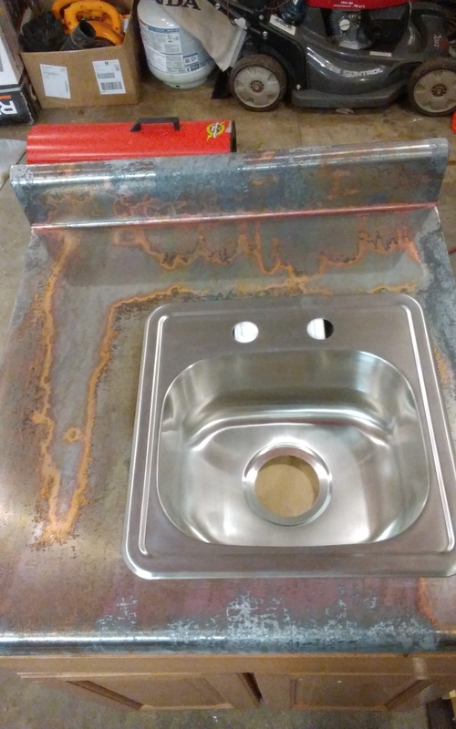

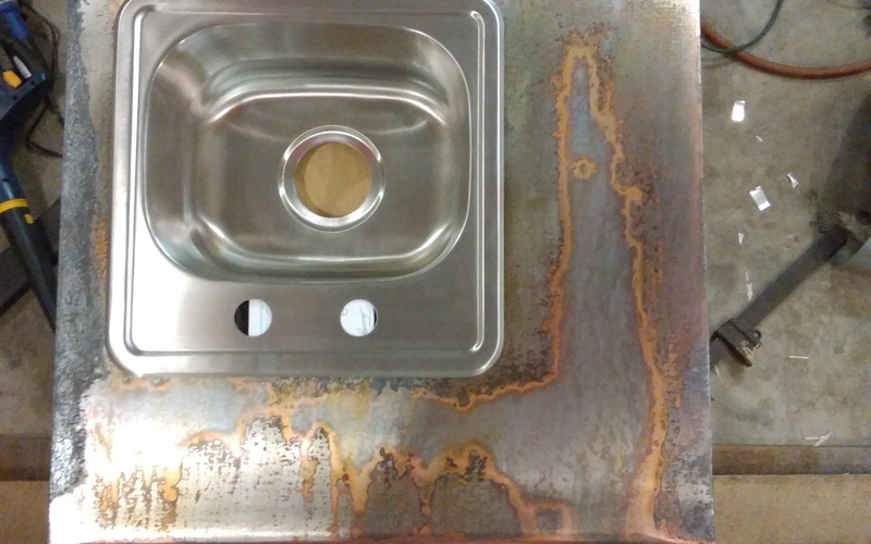

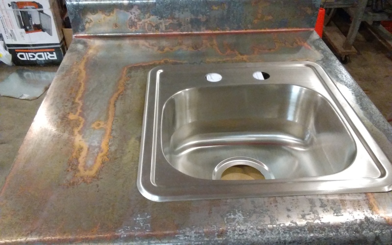

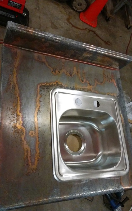

  I spent the day experimenting with a metal counter top.  I got a piece of duct sheet metal from the hardware store and bent it to fit over a old counter top.  Then acid washed it, and followed up with another acid wash (with some acid that had a piece of copper soaking in it for a couple days)...
  The first wash took off some galvanize and made black stains, the second wash (with the copper solution) made the thing really "pop"...
  This top was an experiment but I really liked the way it turned out..  The wife loved it so we will be planning on doing the bathroom and kitchen counters with this process..
  The pictures really don't do justice to the colors, the copper is really much stronger then is showing up...

  Honestly, I haven't got a clue, I was originally planning on doing copper and clear coating it (that's what they say to do), but I wanted to try this first since it was a lot cheaper...  Either way I go, I will still clear coat it..  If it doesn't hold up long term I'll just replace it since there isn't a lot of money involved and I don't have a lot of counter space..
  I just thought it would look nice with gray weathered oak trim work, brushed nickel fixtures, stainless bowl.. It will have to be one of those "time will tell" things...
