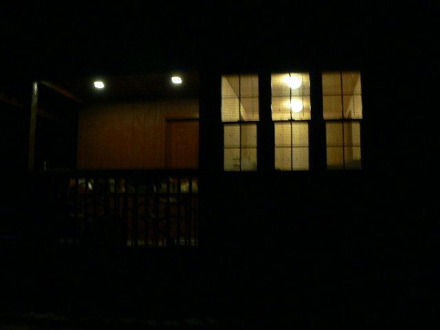

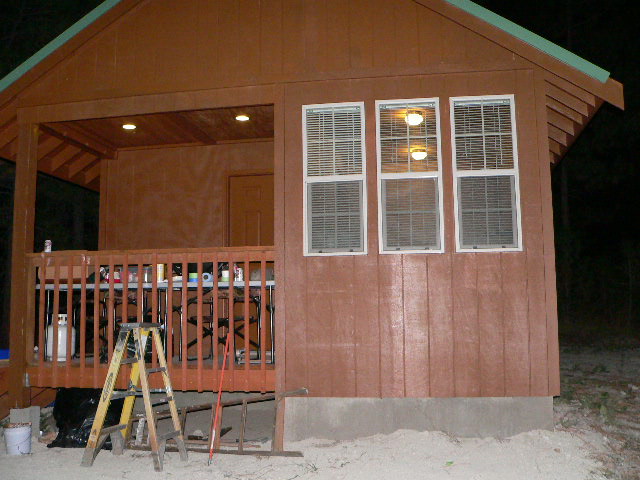

Speaking of thermodynamics, here is my compact floresent lighting which sips power from either the generator ir the Xantrax 2000 inverter (1000 watts continous) All the comforts of home and you cant even hear the Honda gennie running.
