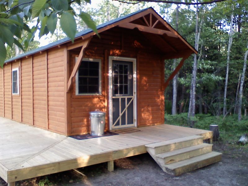

 yes, i have one and i love it. you can see pics of it on this sight. well built  and easy to assemble. some models are insulated. if you should call panel concepts tell John i said hi.

 Larry, thanks for the response. Your cabin looks awesome! What size is it? The deck looks great. But my wife was wondering what you did to keep water from seeping under the wall, we were thinking maybe a flashing or something like that would work.

 Wow, great looking cabin!

 there is a foam seal under the wall, used more often in wood on cement construction. SCHOOLCRAFT.... build near seney, i love it there! i goofed when i said in a earlier post it was 16x32,  it is 12x32 in west branch.. i think 6 inch walls would have plenty of insulation.  thank you toyota tech.
