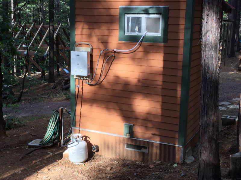

The on-demand water heaters that use a pvc flu are the ultra high efficient ones that require 120v current to operate a fan. Probably not an option. You could find a natural draft B-vent type, which allows you to have the water heater inside, or get an outside unit and plumb to the inside. That's what I did for my little bath house- the shower handle comes in through the window, and there's a hot water pipe to the sink.

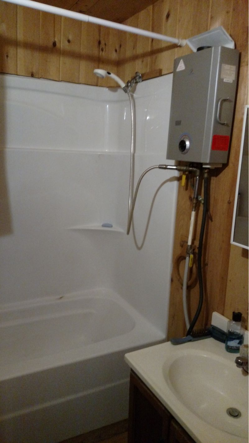

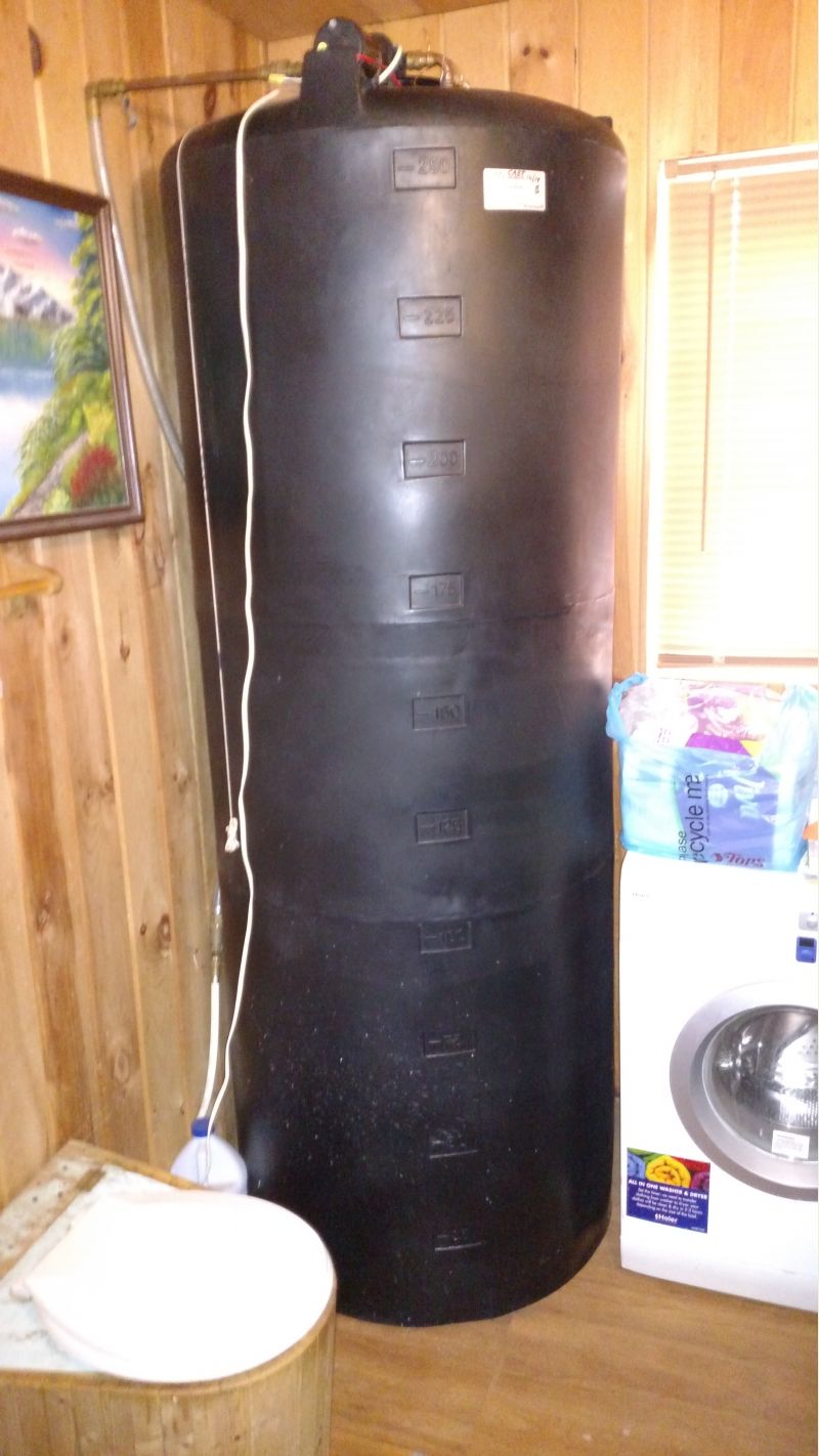

Here is my set up that works fine for me.I have my 250gal.water tank setting in the corner of my bathroom. (reason is I live in a cold weather climate)the 12 volt pump is a 1 1/2 gal per min. Pump.The on demand hot water heater is an Ecco temp L7.I get in the shower,reach out and turn on the water to the heater.It takes about 6 seconds to ignite and be hot water.Yes I let it vent inside but it really is burning no more propane than my kitchen range does with 2 burners going.pluss I've got plenty of fresh air in the area pluss I take a quick shower.my kitchen sink and bathroom sink are hooked to it also.The one thing to warn you about is you must take out or drain the heater and drain the pump if you leave it in freezing tempitures.(I turned one into Swiss cheese!)

so I run an L10 off a 250gal tote to my shower, and kitchen and bathroom sink with a 2.9gpm Flojet pump. It works wonderfully. My only issue is that I put a set of taps in the shower, but can only run the hot and adjust the temp on the L10 if needed. Not a big deal, but would be nice to run the L10 on a higher temp and be able to turn on a bit of cold inside the shower if needed as opposed to reaching out to adjust. If I turn on some cold, there isn't enough water flow and the heater shuts off.
I like the setup so much that I wanted a spare pump in case of a pump failure. So I bought a 5.5gpm pump just to give me the option to adjust water taps. But all that being said, 2.9gpm is tonnes of water flow for a shower and taps. Not all at the same time, but how often does that happen. As long as nobody runs water while someone is in the shower, its not an issue.
I run my L10 inside also, again, short duration, no sleeping in the shower in case of CO buildup, but I have yet to measure any in my bathroom. Not recommending it, clearly against all the safety warnings on the unit. But I like to live on the edge, and want to have a shower even when its below freezing out.

# Posted: 3 Mar 2017 09:43
