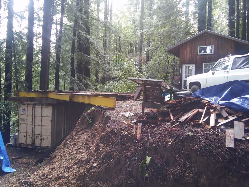

I have one next to my cabin that I use for tools and storage and I'm laying a deck out on top of it. It was free. Not bad in the summer but but cold and wet now. I sure wouldn't want to live in it.

I love the one in the photo with the deck on top — great idea.

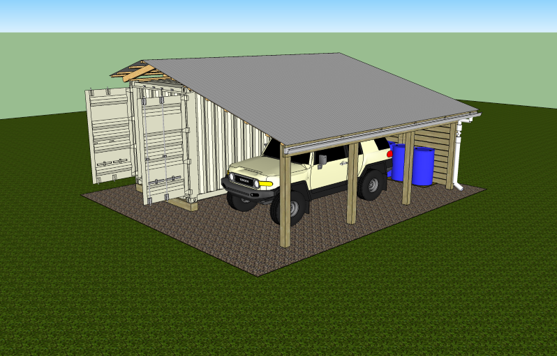

On my wish list is to build a carport attached to a shipping container. This will provide shade for the container in the summer, additional water collection and storage underneath, and a covered work area or carport depending on need. The pic below shows my plan.
