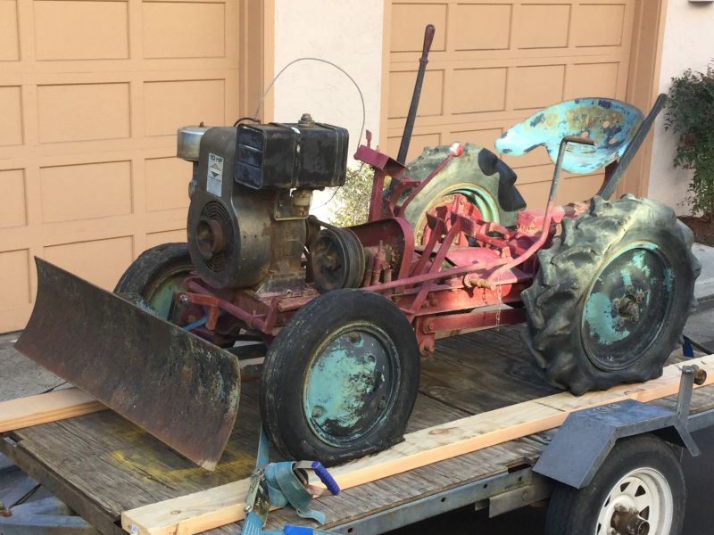

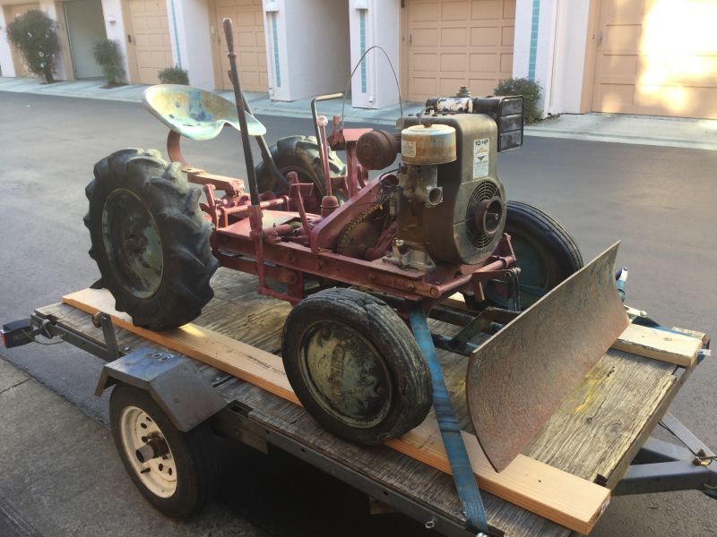

I've always wanted one of these since I first saw them, now one is sitting in my garage. It's a 1945 Gibson model A tractor, originally powered by a 6 horsepower Wisconsin engine, but the Briggs on it is a later replacement.

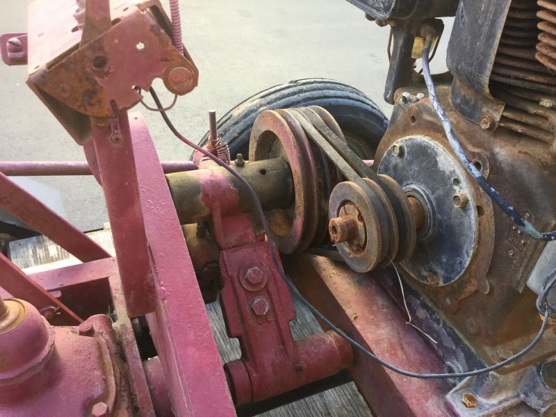

It steers with the large lever on the right, has a 3 speed with reverse transmission and bizarre clutch that is a moveable jack shaft that loosens the belts coming off the engine. Blade up front should move some snow. Also has a tined ripper bar for the rear, which I hope will chop ice on the road.
Rumor is that when they began production in Seattle in 1944, they could not get enough metal to make differentials because of the war, so they scavenged Ford model A differentials from junk yards, altered and repaired them, and fitted them to the tractors.
I'm thinking about converting it to electric.

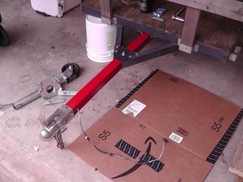

I have that same trailer. Had to replace the tongue with a fully square tube because I jackknifed it with the ATV.

Looks like fun, easy to work on. That's no Model A rear end.

My dad had that exact same tractor, I loved it. We had it parked kind of close to the road off the side of our long driveway and I was still in grade school and our bus driver kept asking about it. Must of been early 70's. Anyway, dad sold it to him for $35, I remember he bought it for $20. I used to play on it all the time. It was a Wisconsin engine, I think it was bigger than 6HP, maybe 9 or 10? Tiller lever steering. We had the blade in front and a plow for the back, we never attached the plow. Identical to the one you have there bldg_insp

Toyota- these old Gibsons are still pretty readily available on craigslist or elsewhere. Don't cost much, lot of fun, and can get some work done. Unusual and slightly bizarre, they get everyone's attention.

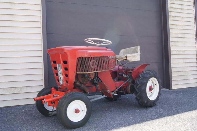

Cowracer- that's a cool little unit with a unique design. Makes me wonder why a good idea like that would go by the wayside. Apparently there have been a number of small tractor manufacturers over the years, from mowers on up. I stopped at a gas station on the way home with the tractor, this guy pulls over and asks me about it, said he has a old Devere tractor with a Kohler engine. Never heard of it- looked it up and sure enough you'll find them on the web, but no one seems to know anything about the company that made them. And don't forget the Farmall Cub, probably the most famous of dinky tractors.
Paulz- I was told they used model A difs, but I'm still researching. They used a different design in later years.
DaveBell- that trailer of mine is the ratiest piece of garbage ever allowed on the highway, but it works. It folds up onto casters, so I can store it in my condo garage conveniently. Poorly made, I've modified it several times and replaced the wheels once. The day I get rid of it I'll give it a kiss before throwing it off the cliff.

Ours said "Gibson" right on the rear diff. It was the only way we knew it was a Gibson. I remember it on the cover over the rear diff.
Some info on it, explains the model A too
http://www.tractorfriends.org/lawngardentractors/gibsontractors/Gibson%20Tractors.htm l
# Posted: 13 Mar 2017 09:05pm
That's a good read on Gibsons Toyota, thanks. Apparently they used auto parts from a bunch of different cars- Fords, Chrysler, whatever was available. I opened up my transmission today and was surprised at how heavy it is- given that it's for a 6 or 10 horsepower engine. It's definitely from a car or truck.
# Posted: 13 Mar 2017 09:34pm
OK, from the info I read, I am certain dads was a model D, it did have the optional rear fenders. It was gray, but they mentioned Ford grey and Wisconsin gray. It looks identical to the gray model D in the webpage photos.

Another quality product from China. The instructions failed to mention packing the bearings. As I packed mine during assembly, I wondered how many people didn't know to do this. How long does a wheel bearing last with no grease? The 2x4 brackets where made exactly 2x4, so my 2x4 fence is a little wobbly. The ground for the lights was supposed to attach to the frame. I home run mine, lights to connector.
I got the 2000 lb axle upgrade. So for $500, it works for me. Even with the wiring spliced in six places.
# Posted: 15 Mar 2017 02:50pm - Edited by: bldginsp
It's supposed to be a 'folding trailer', but in order to release the two halves you had to climb under it to get at several badly located bolts. Why make a folding trailer if you are not going to make it fold easily? So I drilled holes and installed brackets etc. so now it's a lot easier to fold and unfold.
My wheel bearings went bad, so I took them into a trailer dealer to have him pull the bearing shells and get new bearings. Nope, he said, can't do that, have to trash the whole wheels and buy new. Ridiculous. Then I asked him how often the seals should be replaced on the wheels, he said every two years. What? So you are supposed to change seals and repack bearings every two years or else you have to buy new wheels when the seals go and dirt and water get in.
Wish I had a catapult large enough to land this thing in downtown Shanghai.
# Posted: 15 Mar 2017 05:38pm - Edited by: KinAlberta
Bearing buddies? I think that's what they were called. Added zirks...
Here:
http://www.bearingbuddy.com

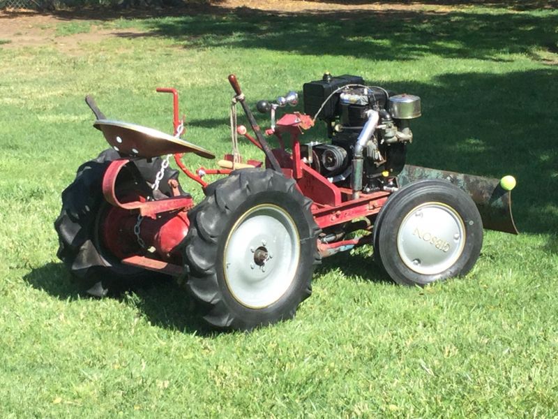

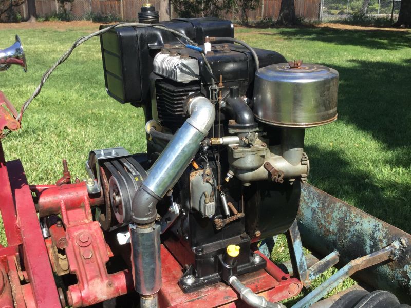

Spruced it up a bit. This will work well for snow clearing in tight spots, it has a very tight turning radius. With a box mounted on the back it will haul tools and whatnot around the property. A cultivator on the back may be useful for breaking up ice on the road. And it will raise a chuckle or two at the annual 4th July parade.
