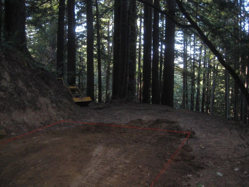

Thanks Steve. I don't have a photo of the stairs handy, they are between the tractor and foundation layout in this photo. It's sort of a rocky sandstone I guess. Need a pick to dig it, a stake will go in a foot or two. I'm confident stakes would stay in place. Pretty sure I've seen other stairs done this way though, and eventually the dirt gives out under the vertical board.

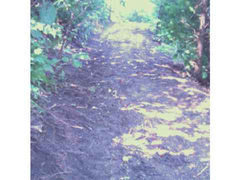

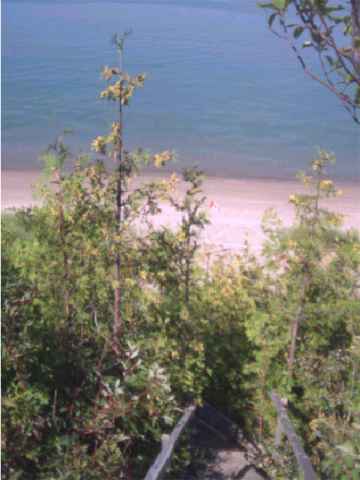

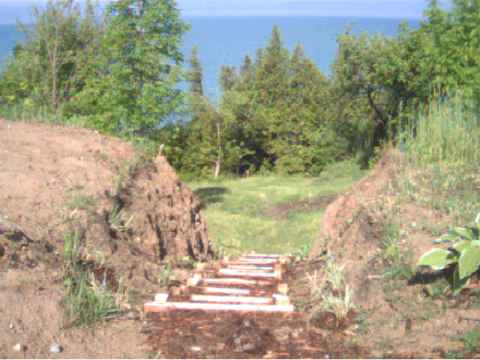

it's been a wile , I once had a cabin on a hill that needed steps in part of the path that led to the beach .We solved our dilemma with a combination 78 steps and a herringbone path . I found in my rocky clay soil a4 in PT stake 16 in long worked well . Picture quality is poor my first digital camera .. 76 77 78
|  250 new path
|  wood steps
# Posted: 10 Apr 2017 01:22pm
Reply Quote
I found as soon as you can get some vegetation growing the better erosion control you get. Took about two years for them to settle in.

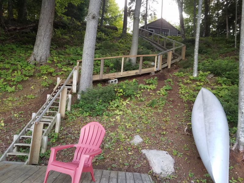

If you can afford stone or concrete block, that will last the longest. I have a steep slope from lake to cabin. We were able to do a cheaper option with pt 2x 8 on edge and pt 2x4 stakes in front. I had seen this approach at a state campground. Could also use pt 6x6 with rebar driven through a predrilled hole. Here is a picture

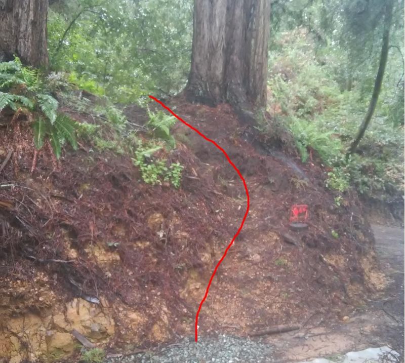

Here's the spot I'm working with. The stairs are almost gone from winter but they follow the red line.
# Posted: 12 Apr 2017 06:19pm
Reply Quote
I wouldn't rule out concrete, if you can get a truck in there. Most expensive and most labor intensive way to do it, but done right the most long lasting.
If you can come up with a ready supply of stone, a stone and mortar staircase is not too difficult. No concrete trucks cause you mix mortar as you go. Much less mortar than concrete cause it's mostly stone. No forms required. Still important to dig deep and include rebar. Fun, permanent, and very attractive. Stone suppliers will deliver if the truck can get in. Otherwise, many trips to some local supply of unwanted stone.

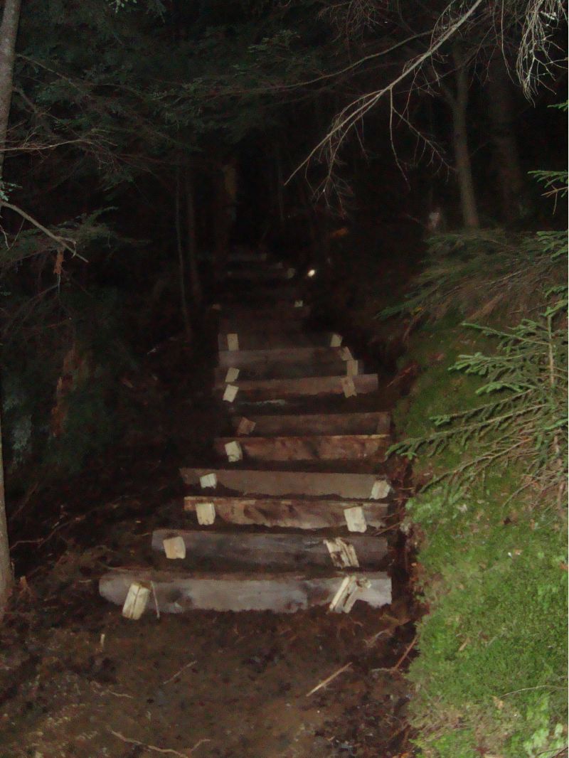

I put this in over several years and it works fabulously. If you are interested in info/details comment back to me. Glad to help.
Eddy G
# Posted: 31 Aug 2017 05:04am - Edited by: Eddy G
Reply Quote
 bobrok, that's a work of art... nice job
