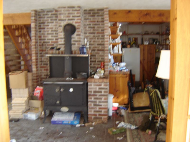

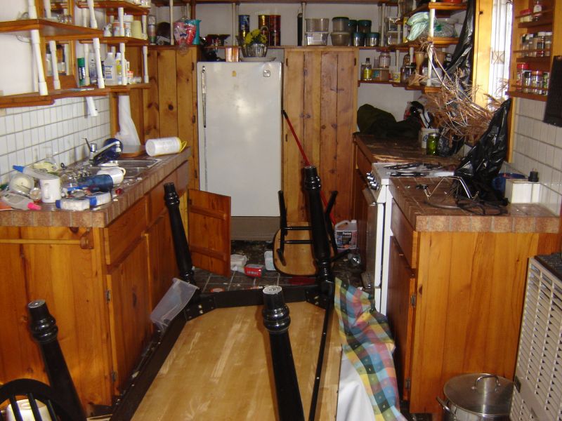

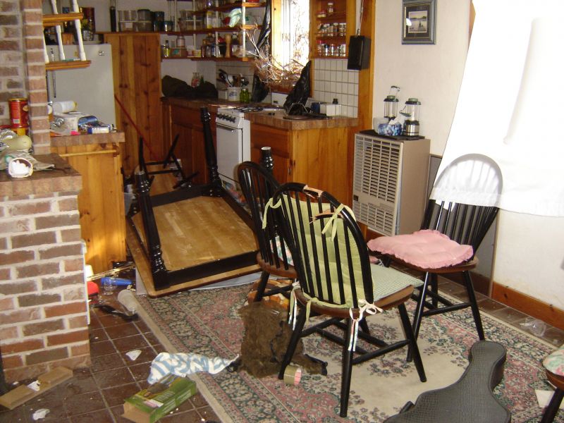

I couldn't make it to my cottage during the winter due to an illness. I was absent for a month, with snow building up they know you are not there, they come in during a storm early in the morning...Nothing will stop them. These guys use Google to scan all the lakes and look for remote places. One look and they know, its an easy target. Its one thing to break in but to trash a place is another.....Just a few pics. I had roofers in last summer and the RCMP told me two of the young guys on the crew where known to the police. They fired off one of the extinguishers, what a mess.

Awful to see. So sorry this happened to you Jebediah.

So so sorry Jeb. The bastards.Had mine broken into also.

So sorry Jebediah, when my cabin was broken into, I think we lucked out. My neighbors had their wall cut into to gain entrance, but they found one of our windows they could remove and climb in. They did take everything they could get money for, but were considerate enough not to trash the place. They even set my glass propane globes in a row on the table unbroken (yet they pulled the copper lines out of the panel walls). Stinks all the same, while we were not out much financially, it still wasted days out of our next trip to run new gas lines and get new pot pans etc.

So sorry this happened to you that's so violating
