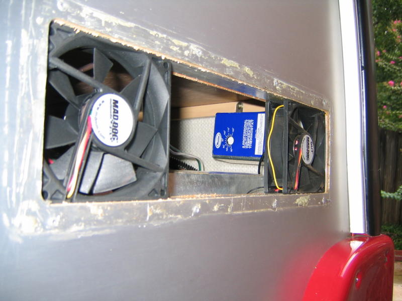

Norcold RV fridges on LP do need a circulation fan when used as a built-in/within an enclosure. You can use a 12vdc "computer" fan, which should be nice and quiet.

Locate the fan at the top, blowing out.
dual vent fans & thermostat
drb777
# Posted: 15 May 2017 03:16pm
Photo above shows "computer fans" and optional thermostat located just behind the top vent of the fridge compartment. Instead of the thermostat, you could use a simple rocker switch or both.
