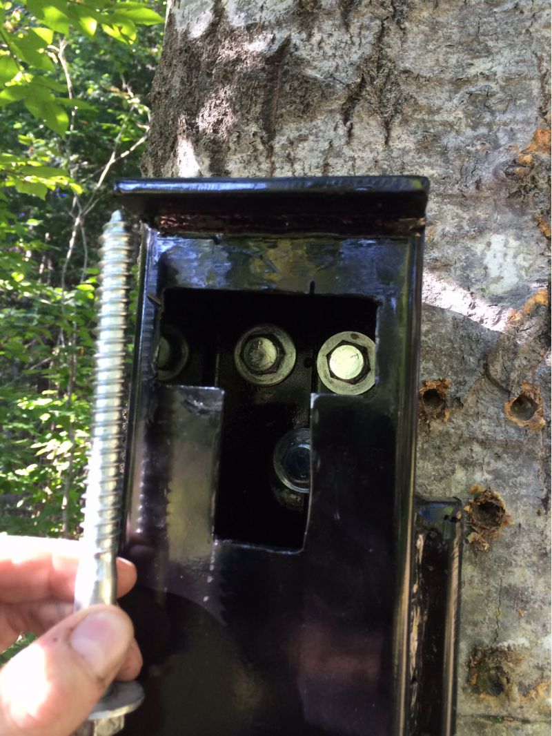

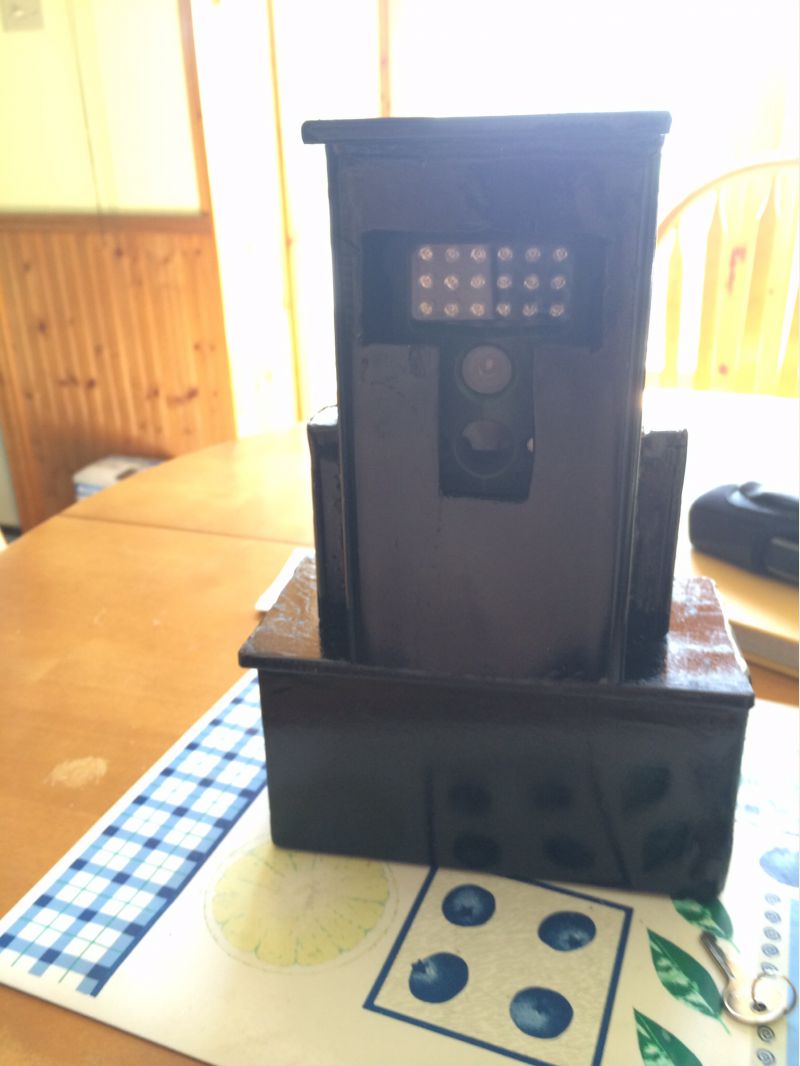

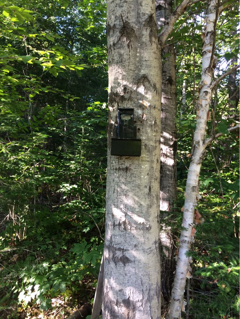

I installed trail cams, they can break the camera but I'd have the card. I have one at my gate the rest are hidden. And, build a hasp that's a little harder to cut. Just making it a little more inconvenient for the thieves. Two locks on trail cam unit that can't be cut.

Here's a better pic of my case I built for trial cam.

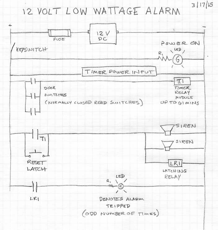

Here's how it works... 12 volt system The timer relay module (see amazon link above) requires 12 volts, and can switch up to 30 amps. The timer relay will make contact if voltage is applied to a pair of terminals, will do via reed switches mounted on each cabin entry. Timer relay can be adjusted to stay on up to 61 minutes, but that's a bit long to run a (exterior mounted) siren. I think 1 minute is enough. A keyswitch on cabin exterior with green LED (and current limiting resistor) tells me the alarm is on. A latching relay with red LED (and current limiting resistor) will tell me if alarm has been tripped, providing it is tripped odd number of times. These LED's will show on outside of cabin prior to disabling alarm with keyswitch.
Latching relay is reset by "goosing" the relay with momentary contact switch. I didn't go fancy with a alarm counter since I figure once alarm goes off, they won't bother coming back.
I plan for reed switches on my storm doors as well as entry doors. Idea is to alarm when storm door opened so bad guys don't kick in entry door (lotsa work to fix). Storm doors have closers that should open reed switches once door closes. If reed switches fail or if doors left open, the alarm will cycle on and off til batteries die or neighbors burn down cabin to stop noise source, whichever comes first. Any other ideas on this?
Timer relay module uses about 10 mA at rest, 25-50 when active (making contact).
Siren uses 200 mA.

30 amps is the max current the timer module can switch at 30 V DC. 12 volt DC max amperage wasn't listed. The total amps at 12 volts going though the timer relay module with horns blaring will probably be under one amp, so still room to grow if need be. Sirens use about 200 milliamps each if I understood the spec correctly.
For the uninitiated, relays use electromagnetism to close switches or contacts. The relays are used to close the contacts/switches in a controlled manner so the siren doesn't keep running until the battery is exhausted. Relay T1 closes T1 contacts, latching relay LR1 switches LR1 contacts electromagnetically but keeps them closed without using continuous power (special relay type). That allows the red LED to stay lit (low power draw) signal that alarm was tripped.
The door switches are "normally closed" reed switches. In their relaxed state, their contacts are shorted, but become open in the presence of a magnet.
By installing switches on the storm doors (with mechanical closers) the alarm should sound before the entry door gets kicked in, hopefully scaring off the intruder.
The part that bothers me is that if a door switch fails (or if the door gets kicked in anyway), the alarm goes off for the given time, resets itself, then goes off again until the battery runs out. My neighbors might find this annoying... And if the sheriff calls me at 2 am, I really don't want to drive there to shut if off.
Anyhoo, I'm mulling the circuit over a little bit before I order parts for a prototype. So many projects, so little time.
