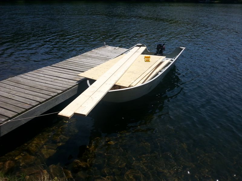

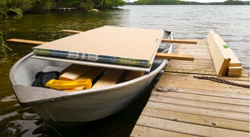

I've moved more things to and from my island in a 14ft POS aluminum boat than I can count - fridge, stove, steel roofing, materials to build two 108 sq ft cabins, concrete mix, mattresses, etc. That may be all you need.

I've build additions, decks, etc and hauled all of my material in via a very similar boat (yours looks a little wider).
However, if I was looking to start over from scratch - I'd be very tempted to invest in a used pontoon boat to haul the material over, then sell it after.
Not only is it a lot less work, it's safer. It's very tempting to overload the 14' boat and many times that load is placed "up high" like pictured. I'm not saying you were unsafe - god knows I've done that and worse but at times the boat has been very "tippy".

Actually, it's not to bad with the drywall up on the gunwales like that, eight sheets or so at a time so around 350lbs. I figure I've moved 100+ sheets over in the last decade or so.
