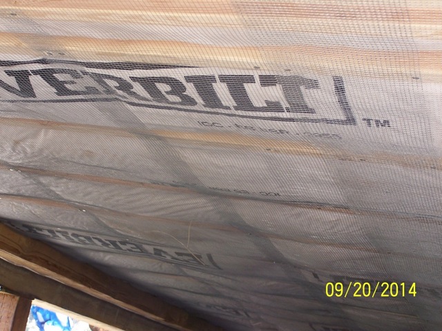

# Posted: 17 Jun 2017 01:11pm - Edited by: DRR
What I have under my cabin. Just some old fashioned wire mesh.
