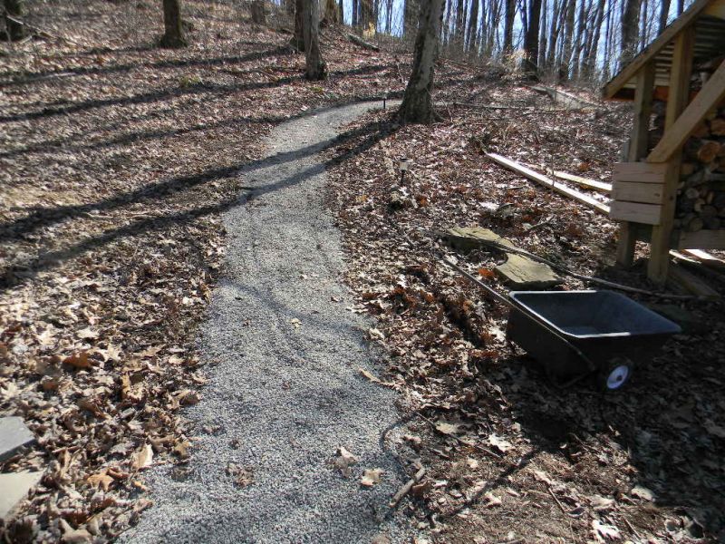

Driveway slope up the hill is about 20%, and has a recent (spring) application of 067 gravel (recommended by hauler). Recent application due to sinking of tracks/bottoming out on center strip.
Problem is, the gravel isn't locking in. My vehicle (even with traction control) needs a running start on the flat portion of the driveway to get up the hill, and if vehicle bounces a bit the tires spin and create ruts. I'm frequently re-raking the driveway smooth. A friend stopped by and had to work 10 minutes to get up my 110' driveway! I wasn't home for the amusement, unfortunately. I did later have to get my rake out, though, which would have amused him.

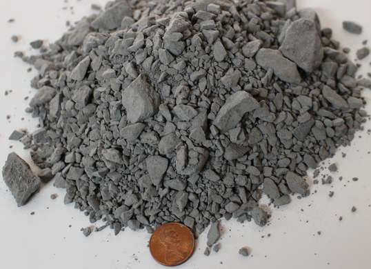

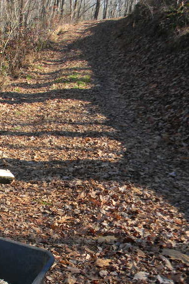

I've added smaller gravel from "extra gravel" pile (picture) to attempt to lock in the 067, that helps minimally.

Driveway with 067 gravel and leaves
Smaller gravel and small helper
Extra gravel
Extra gravel

You need to get some fines mixed in with the gravel. Here they call it 3/4 minus, which means angular pieces of 3/4 rock and stone dust. The angular rock locks in better and the stone dust fills the gaps and sets everything in. After a few years the driveway should be as hard as concrete.

Looks like the leaves haven't been cleared in years. Gravel too small. You may have too much slope for standard vehicle differential. I have the same situation. I keep the leaves cleared off. I put down three inch gravel. And still have to use 4x4. So start by clearing your leaves and putting large gravel in the right track.

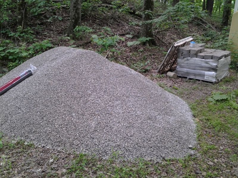

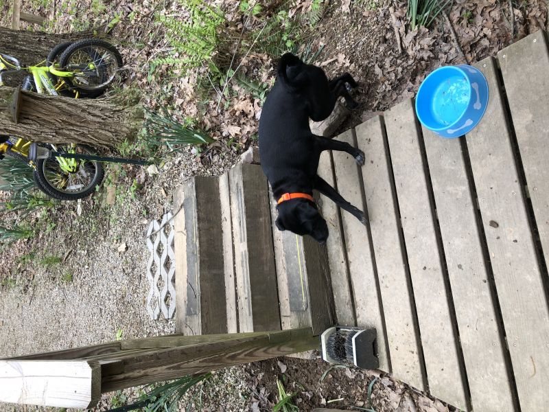

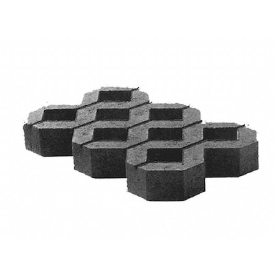

These turf stone blocks are about $3 USD per foot at Menards. I’ve set them on only the sunken side of driveway.. No more spinning gravel!
I also used one on my cabin path. A heavy rain would often result in a torrent washing gravel down my steps. The turf stone and gravel base underneath provide good drainage. No more overflow cleanup.

Turf stone on path steps

Driveway paver turfstone
Turf stone
Turf stone
