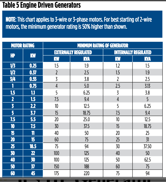

According to the table on the Franklin site regarding pumps...a smaller "internally regulated generator" could be used to run pumps.
I read somewhere a honda EG3500 may be an "internally regulated generator". Can anyone confirm? Looking to try to run a 3/4 hp well pump off of one. Thanks in advance

OK, the Honda EU2000i is 2000, but only 1600 continuous. Maybe a Honda EU3000is be the perfect combo.
My solar well consumes very little, but its run on 12-36VDC and the pipe to the top is only 1/2", ie a livestock well, easily runs on my EU2000i, but output isnt like a fire hydrant, flow is more like a kitchen faucet turn on.
