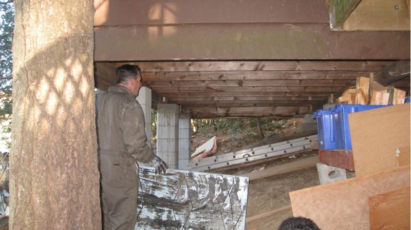

It's amazing how much heat is lost through an uninsulated floor. After our first winter I crawled under there and tacked up 2" thick foam board between the floor joists. Made a huge difference.

Quoting: NorthRick After our first winter I crawled under there and tacked up 2" thick foam board between the floor joists. Made a huge difference.
I never considered that. I guess rodents don't/can't nest in a foam board. I might just have to lay in some foam board this summer and give it a try. I just looked up on Home Depot, they have 2" thick 4x8 sheets of Thermasheath Rmax board with an R value of 13.1 (which seems insanely high to me for a 2" board) for about 30 bucks a sheet. I'll need 8 sheets for my 16x16 floor, which is $240.
If it is really r13, that's more than enough for not a whole lot of cash. Thanks for the suggestion!

R13, ha! They are making stuff up. Figure on R4 to R5 per inch depending on which type of foam board it is. That said, it still makes a noticeable difference.

Foam board comes in 3 types. eps: R3 I think? Xps: R5 and PolyIso: R6.5 So 2" at R13 is correct.
One trick to stuffing rigid insulation between rafters/joists/studs is to cut it a bit small and then use spray foam to lock it into place. Much faster, easier and tighter.

Quoting: creeky One trick to stuffing rigid insulation between rafters/joists/studs is to cut it a bit small and then use spray foam to lock it into place. Much faster, easier and tighter.
I'm all ears...
Define "a bit small"... like a quarter inch? Do you still nail/staple it to the sub-floor? Do you just spray foam it at the edges, or run a bead across the surface like liquid nails?
Gonna be doing this come spring. The full procedure would be very helpful.

Quoting: Cowracer Define "a bit small"... like a quarter inch? Do you still nail/staple it to the sub-floor? Do you just spray foam it at the edges, or run a bead across the surface like liquid nails?
Have a look at this video: https://www.youtube.com/watch?v=90bG4c4ssJc

I'm in the same boat in regards to the floor. (Raised on piers). In this case, when insulating between floor joists (or across), does it matter what type of foam to use? (eps, xps, or polyiso) Any real concerns about fire if not covered? (ie: is it any worse than just the exposed wood?)
KelVarnsen
# Posted: 8 Jan 2018 11:27am
It was a miserable job to install the foam. My joist bays were all inconsistent sizes. I had to make a map with detailed measurements and then cut all the foam at home before I hauled it to the cabin. It wasn't so bad installing on the front half of the cabin because it is higher off the ground. I was lying on my back on rocks and dirt, bugs falling in my face, when doing the back half.
By the way I found a local building supply recycler and got the foam at less than half price. It came off an old school roof. Might be an option for someone else.

Quoting: SCSJeff Any real concerns about fire if not covered? (ie: is it any worse than just the exposed wood?)
I got a feeling that if fire gets up underneath my cabin, it wont matter a whit if its eating wood or foam. Its probably gonna burn the whole place to the ground.

Quoting: KelVarnsen It was a miserable job to install the foam.
I've read it would be better to go across the bottom of the joists anyway. I guess that would make the installation quite a bit easier than going inside the joists too. I'm just not sure I would like visually seeing the insulation more that way Curious, did you notice a difference? And was it enough to be worth the installation hassle?

Quoting: SCSJeff Curious, did you notice a difference? And was it enough to be worth the installation hassle?
I'm pretty sure it was worth the hassle, but I don't really have a "before" test to know for sure. I never really spent anytime at the cabin in the winter before installation. The previous owner had actually insulated the joist bays with about 1" of pink fiberglass and then cut plywood to go over top of the insulation, secured with strapping. So I pulled down the strapping, plywood and fiberglass. Then installed the foam and put the plywood and strapping back up to hold the foam.
I agree that it would probably provide better insulation value if installed across the joists (reduce thermal bridging), but I have some plans for storage, such as kayak hangers, under the cabin. I thought having the foam exposed would be bad for critters and my future storage plans.
The floor was still pretty chilly on our weekend trip. We were only there for a couple of days and it did start to warm up.
