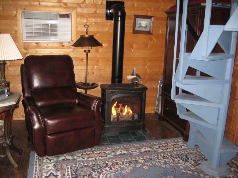

I had the same choice to make when I installed the gas DV stove shown below. As you can see, I chose 4' vertical inside, then out, mostly because of a more traditional look. From the outside you'll need to consider the look and practicality, to me it didn't fit or even look correct (to have external vertical section). Like you, my factory instructions said either way was functionally correct. But after 3 years of use, I'm glad I went with an interior vertical section.

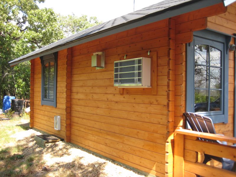

drb777
# Posted: 12 Feb 2018 01:15pm
Exterior photo, DV gas stove venting. Unobtrusive vent cap shown, nice not having to support any exterior stacks.
