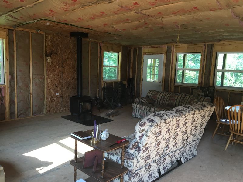

I agree with ICC. I would think about putting 2 heaters in a cabin of that size.
You may want to consider what we did. We have a wood stove and a housewarmer brand from Northern that is 15,000 BTU. Our cabin is about 600 SF on a single floor. We still need to seal up things a little better and finish the inside, but I think just the propane heater will have a tough time when temps are around zero. The two of them can heat the place up in a hurry when we arrive. The propane is on a thermostat so it won't run much when the wood stove is going. It is nice though that it kicks on in the middle of the night when the wood stove dies down. Also you can just run it when you just need a little heat and the wood stove would be too much.
I agree that the woodstove does take up some room, but to me it just isn't a cabin without one. We got a glass front, so you can watch the flames dance in the evening.
PS. We also put the heaters on opposite sides of the cabin. With no fan to circulate air it helps spread the heat out.
Here are some pics. Like I said we have to finish the inside this year.

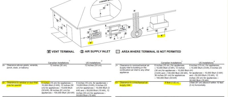

# Posted: 29 Mar 2018 05:43am
Here in NS Canada, your vented heater has to be, I think a min of 6' from any openings/ window or door, don't quote me on that as it was sometime ago when an inspector had mentioned that to me, I wondered why the place had a few solid glass windows that didn't open...... I have two empire heaters, hardly use them now as I replaced the cook stove with a large wood stove.
Wilbour
# Posted: 30 Mar 2018 08:24pm
Maybe you meant 6" ?
# Posted: 30 Mar 2018 09:48pm
No, 6 feet. 6 feet from windows, doors, anything that might allow exhaust to enter the cabin. Also there may be rules for distances from exterior propane tanks, etc etc. The distances may vary by jurisdiction.
# Posted: 31 Mar 2018 10:00am
I never understood who would run their heater and have their window open
Good thing we have laws to make sure the window is far enough away
Wilbour
# Posted: 31 Mar 2018 10:38am

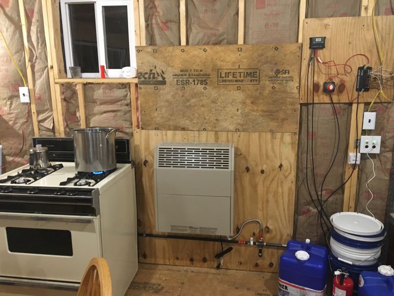

Am I not reading the install instructions correctly?
Looks like in Canada they recommend 6" from an opening window and 6' from a mechanical intake.
Let me know if this is not correct.
# Posted: 31 Mar 2018 10:47am
That's the info I used too. Note it is 6" for appliances under 10k btu and 12" for those over.
I think, Wilbour, you have the 9k btu heater?
The hardest part for me was the 3' from a corner of a building. It has something to do with wind. But in a tiny house. 3' is a long way!
