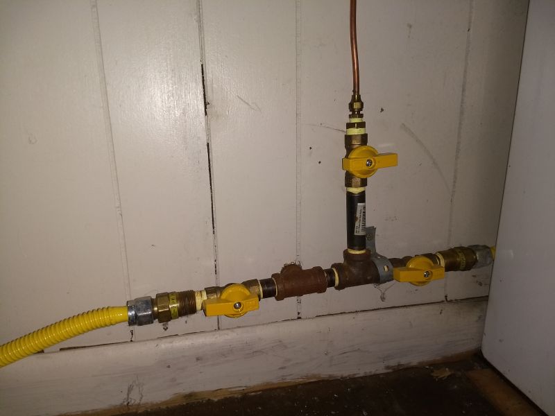

  We run propane for the fridge/lights/and stove, in our cabin. I ran the black iron from the tank outside to a black iron manifold inside and added a cut-off fitting, that if it sensed unregulated flow, it shuts them all down. With that, in the manifold I also installed shut-off valves for each take-off. The sensing valve would work if we aren't there and a line is broke, and the valves are great if we are there and want to isolate. All the valves and shutoffs are inside of the cabin (we had the previous copper lines stolen inside and out). Next up for us is battery smoke/CO detectors, since the cabin hasn't ever had any. We keep a fire ext. handy near the oven, just in case. I agree, safety first!!!

 Quoting: moneypitfeeder added a cut-off fitting, that if it sensed unregulated flow, it shuts them all down
  Hey monepitfeeder can you post a link or a picture to the valve that you are talking about.  I'd like to look into one for my propane piping plan that I'm working on.  Also if you have picture of your manifold setup that would be great.  Thanks.

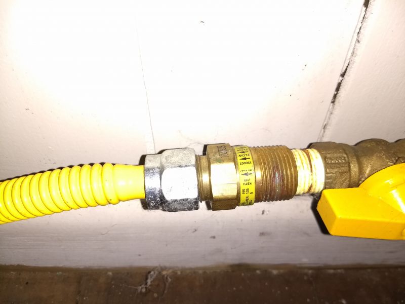

  To KelVarnsen,  In a couple of weeks I can post a pic of our setup, we can't get up to our cabin until the week before Labor Day, but I will be sure to take pics when we are there. The cut-off valve was purchased from Home Depot, but I'm sure other hardware stores carry them.
moneypitfeeder
# Posted: 3 Aug 2018 07:10pm
  Hi KelVarnsen,  Quick update, the valve that we purchased was this or very similar (part of a kit) https://www.homedepot.com/p/BrassCraft-3-ft-Gas-Range-Connector-Kit-with-Auto-Shut-Of f-MA-PM15X115DS/205558421, it was a small fitting that is normally installed in-line with a range line, I think I installed it before the manifold, but I will confirm when we are at our cabin.

# Posted: 13 Sep 2018 06:47pm
  Hi KelVarnsen, I checked when we were up at our cabin, and I have 2 of the safety shut offs (one to the fridge, one to the stove) but I forgot to get one for the line for the gas lights. My manifold is really simple, blk iron line comes in, and splits for 3 purposes (fridge/stove/lights) but I have them all valved so we can shut them down or isolate each take-off. (The lights are the smaller 1/4 copper line that goes straight up) We only have 3 lights running off that line, used to have 5, but when our previous copper lines were stolen, we decided not to run lines to the bedrooms again. We shut the valves for the lights and the stove off every night and only keep the valve for the fridge open while we sleep.  manifold
  |   close-up of safety valve
KelVarnsen
# Posted: 14 Sep 2018 08:36am
  Thanks again moneypitfeeder for taking the time to post all the info and pictures.  It will be helpful when I do some modifications to my current install.
