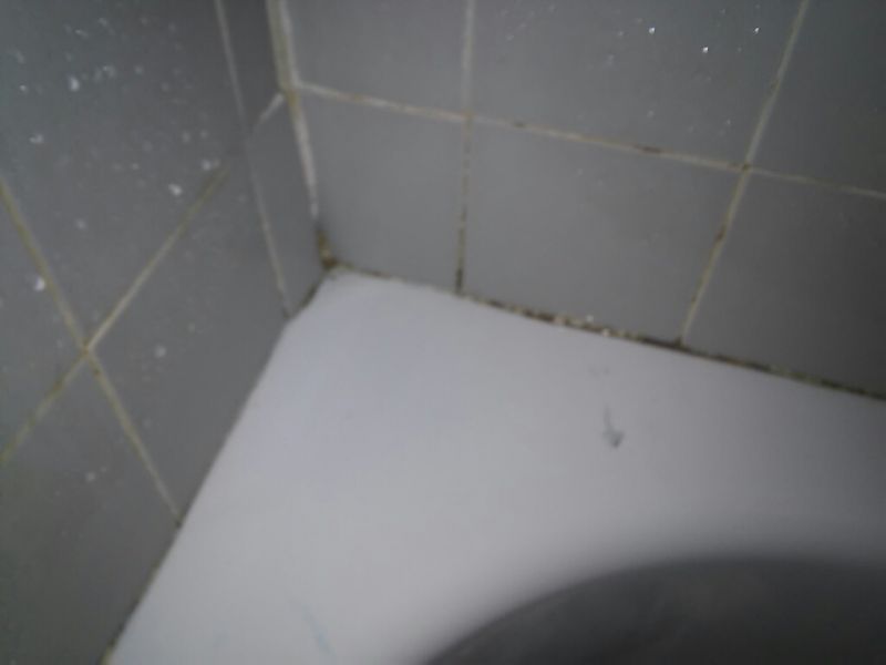

Went to Ace for some X14, banned (at least in California...yes, Ca has changed a lot in the 60 years I've been here..). Probably because it actually works. Bunch of other stuff on the shelf but the salesman told me to just use toilet bowl cleaner, which I have. Didn't work, neither did the two hour bleach soak nor some pine cleaner or Tilex I had. Doesn't look like mold, more like embedded dirt, or something.
Don't have a steam cleaner, hot water out of the shower seems to help a bit. Will try the other suggestions, revert to paint or caulk if I have to. The whole tub and shower need replacing but that won't happen before Labor day, too busy getting the cabin ready for my wife's 50th birthday party. Maybe I should call that One Day Bathroom Remodeler guy on TV...

Looking at the photo, could that be silicone covered grout along the bottom edge between the tub and tile? Mine was and it separated and then got mouldy. I just cut it out really cleaned it up and then re-siliconed the perimeter. (10+ years later it could use a re-do)

After all this guessing, we now get the picture. Paul, post the picture first, please.
You may have two separate problems. The caulk is stained and needs to be replaced. Use caulk, never silicone. Plan on replacing caulk about every five years. When anyone tries to replace the silicone, they will learn why only caulk should be used. No wonder you could not get the stain out. Caulk stains in about five years, silicone stains in about 8-10. You don't want to experience silicone removal.
Is the grout bare or did someone caulk it also? If the grout has a sealer on it or someone tried to cover the grout mess with caulk/silicone, that would explain why bleach didn't work.
The grout needs to be replaced. Some other folks in here may have experience resurfacing grout lines with sandpaper, masonry blade, or other way. I do not.

Sorry, didn't really want to post a photo of my embarrassing bathroom. No silicone or caulk anywhere. I'm able to scrape it clean with a screwdriver. Probably been there 25 years.

IF it's still fixable, I would try a pumice stone, the blocks they use to clean swimming pool tile, I've had lots of luck with those...
If it's beyond fixing and you need to remove and regrout, the multi-tools have a blade made for that that makes it a breeze...

I got this grout tool at Harbor Freight yesterday, the thing is magic! Cleaned up the shower in short order, then I gave it to my wife and she went to town on the kitchen floor. I will need to add some grout I guess but it sure took the gunk out quick!
Thanks for all the replies.

Given the age you said, it is more than likely it is NOT a siliconized grout and as such absorbed the stains. If that is the case, removal & replacement is the only option. I've likely laid over a million square feet of tile and god knows how many ceramic fireplace facias... It is what I did for 3 years, 6 days a week and far too many nights.
Some ideas mentioned "eeks" scary shit ! not even touching that. Lucky you have not gassed yourself yet.
Once grout is replaced with siliconized grout and all set & cleaned up, you can use spray furniture polish on the tub surround etc BUT NOT IN TUB ! The polish will keeps stains off, hardwater minerals and such, easy to wipe down with Tilex Shower Cleaner and a respsray of Pledge and goo to go.
