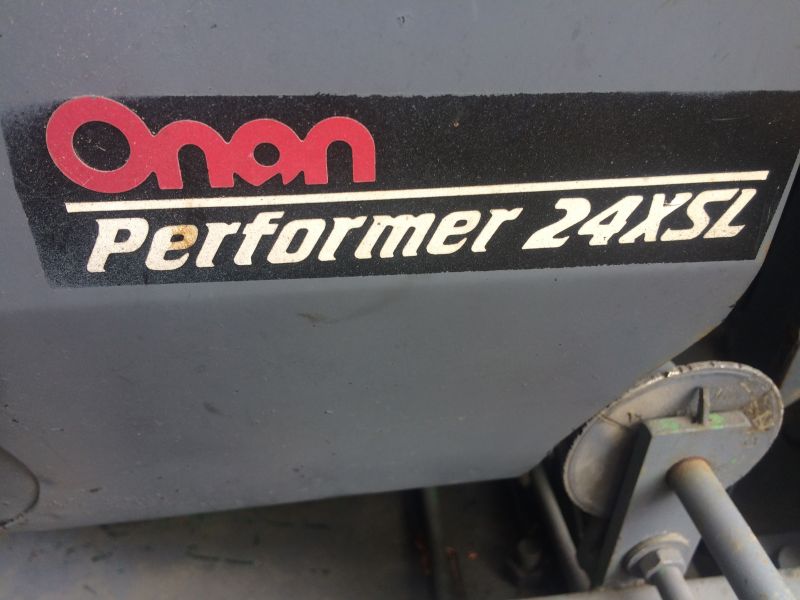

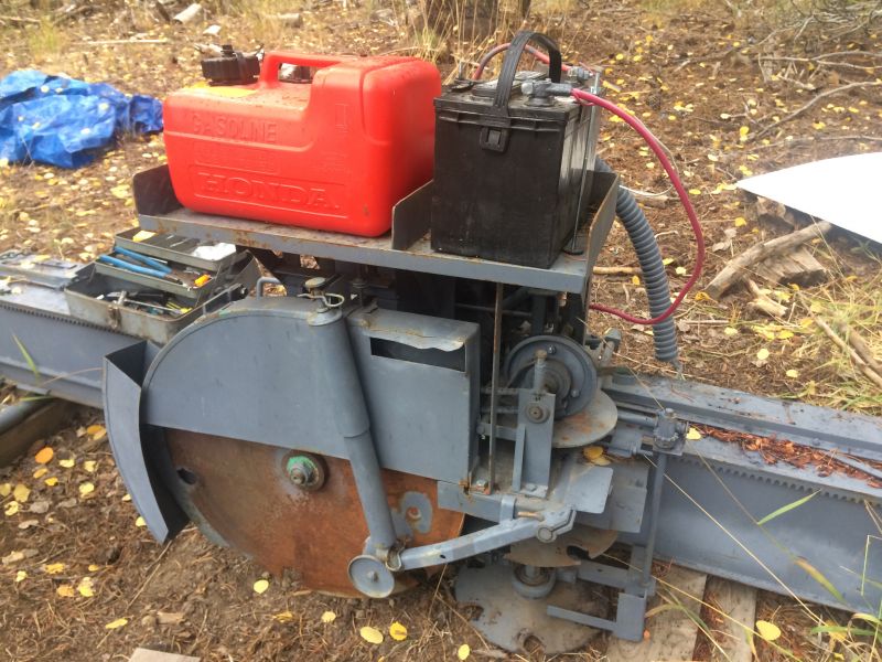

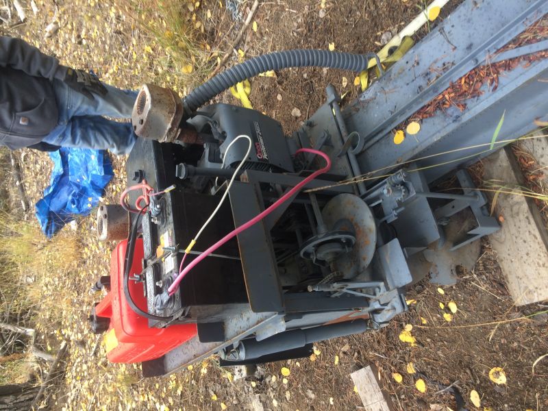

Anyone have any experience or suggestions on a decent sawmill? I have the opportunity to buy this circular sawmill style for 1800. One downside is that you are limited to 9 inch depths (less than have the radius of the blade). It's got 30 feet of automated track. Versus a bandsaw mill from 4K-9k. IMG_0917.JPG

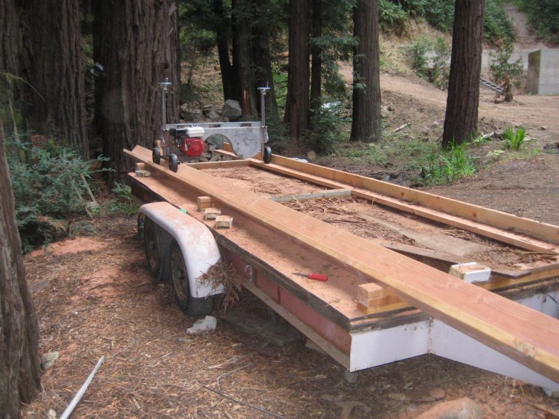

I paid $1500 for my Lumbersmith bandsaw mill, have to make your own track and push it. But you can lift it into a pickup and haul it to the tree. I've cut many 14-16 wide boards but that's really too much for it. Blades are about $40 and I've gone through about a half dozen over the years.

I think the only rub on this one is the limitation on cutting depth. 9 inches. That will work okay for beams. But, I won't be getting any big, beautiful planks out of this mill.

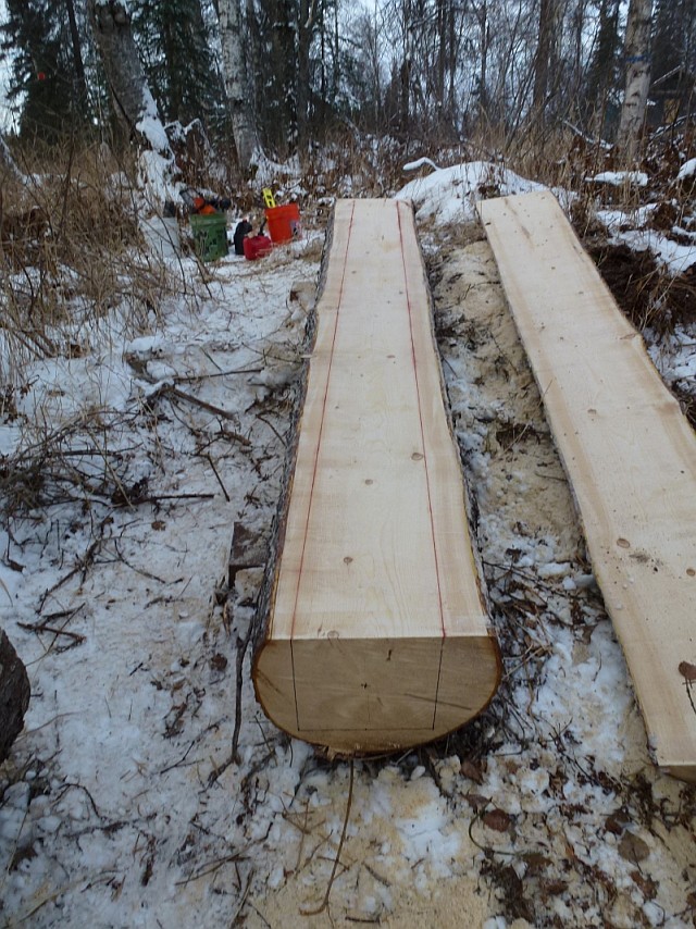

# Posted: 25 Oct 2018 06:58pm - Edited by: NorthRick
This was a 10" by 10" timber in process. That first cut is about 16 inches wide.

The other interesting thing about this one is it has two horizontal blades that work in tandem with the horizontal. So, you are getting 3 cuts at once. BUT, the horizontal blades are only producing 4.5 inch cuts.
I think it could make a quick go of a 3 sided D log cabin wall.
