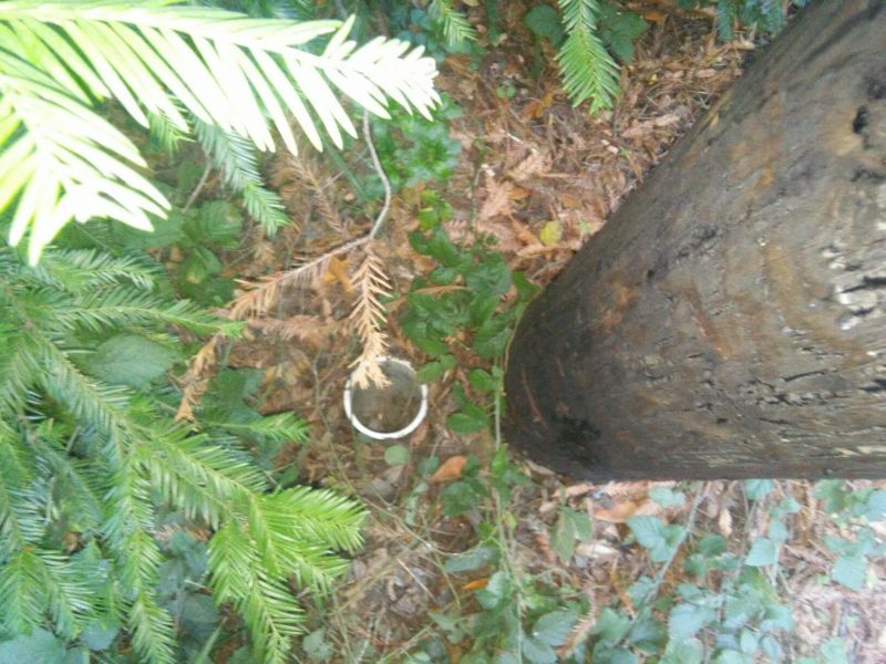

They, we went out to look at the telephone pole out front of my gate. It's just telephone, the power poles are across the street. Next to the pole there's a pipe sticking up. I have no idea where it goes, probably not where I would like but I'd like to know. How can I test it to find out?

Maybe blow compressed air into it, look/listen for the air escaping. You could also take a tape measure and stick it down the pipe. A tape measure always rolls up or bends one way. Maybe that would help figure out which way the pipe is running.
# Posted: 30 Oct 2018 09:55pm
Thanks darz. Air, good idea. I was thinking about water but I'd probably just end up with a pipe full of water.
# Posted: 31 Oct 2018 09:42am - Edited by: paulz
Have another idea on locating that existing pipe. I have one of those loud hand held boat air horns, might try blowing that into the pipe.

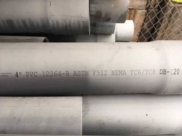

Also, a local electrical contractor is selling 20' sticks of 4" heavy wall pipe for a buck a foot, way less than 2" schedule 80 ($3 a foot).

Yesterday we attempted to trace that existing pipe. Compressed air ran through so knew it wasn't plugged. Air horn didn't travel down the pipe. I ran a garden hose to it and pumped well water down. And pumped, and pumped. Got more hose and ran it down the pipe. Got over 100' down it, still pumping water. Can't find where it's coming out! So this morning the fiber guy is going to try his tracer.
# Posted: 2 Nov 2018 05:06pm - Edited by: paulz
The plot thickens. The cable guys put their fiberglass rod tracer thingy down the pipe, it went down 5-10 feet then apparently started coiling around. Best guess is there is an underground tank of some sort, not 10 feet from the telephone pole. And I must have pumped 300 gallons in it yesterday. Would explain why is was so easy to shove over 100 feet of hose down there easily. What I can't explain is what a tank is doing right by the road. I have one of those cameras on a wire that hooks to a usb port, I'll try sticking that down there next.

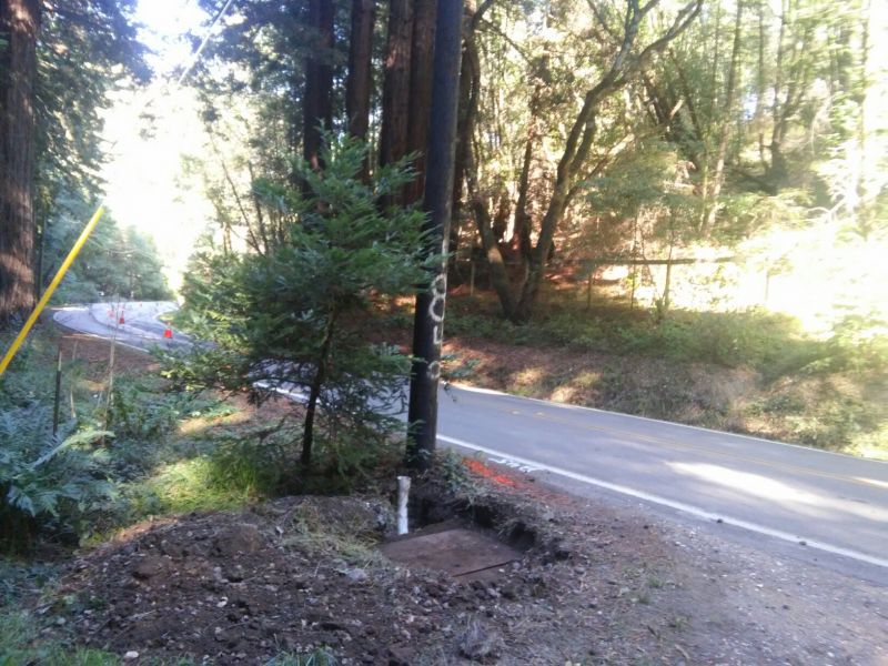

More than likely that tank is actually a vault for fiber optic cable splice points or the power company communications vault. We use them where I work to splice fiber optics from a Central point. The reason it kept taking water is they are often buried on a bed of gravel so they don't hold water.

Why would there only be a 4 inch stub, no way to access the vault?
I called 811 a couple day ago and filed a ticket. They are supposed to notify the gas and telecom companies of my new trench, which will run right over this (I think) so if it's the case, they should tell me. I can't start digging there until Tuesday.

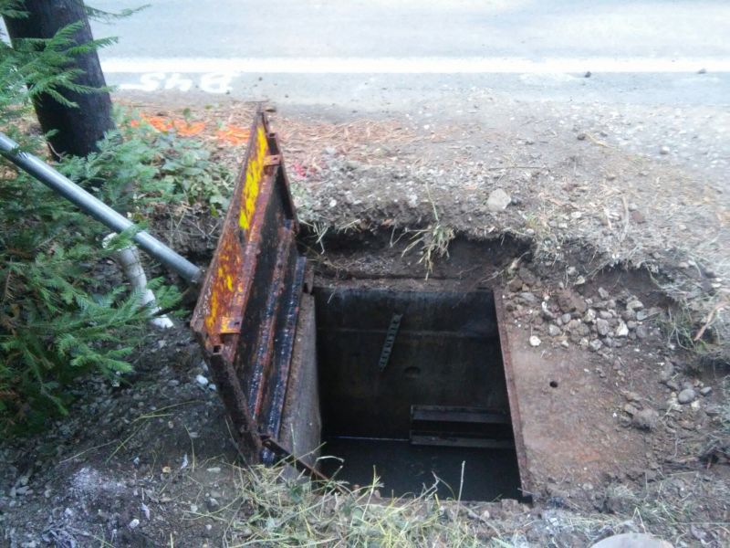

The mystery unravels, some. Some spirited pick and shoveling uncovered this 'vault', as slatecreek predicted. I got pretty excited when I saw exit holes in all four walls, but a brief poke revealed them all to be blocked off. Why would they put this thing in the ground and not run anything to, or through it?
Anyhoo, looks like it's not going to help with my fiber conduit trench dig. 1107180859a_resized..jpg
# Posted: 7 Nov 2018 03:32pm
Now you got a great storm shelter or bunker if ya need it. I assume it wasn't full of water?
# Posted: 7 Nov 2018 04:20pm
Lol, ya I've been thinking there must be something to use it for. Maybe I'll hide in it and yell at the cars that go by. You can see the water level in the first photo. I didn't poke at it to see how deep it is. I'll do that when I clean it out to decorate.

Vaults like this are installed and then they core drill (they are usually concrete or fiberglass) later to tie into them. We do it all the time if we dig up an area and run conduits down a road. As the area develops, we can run a fiber in them and out to the new customers.

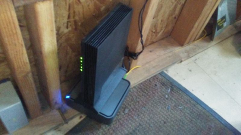

These two boxes are a fiber to ethernet thingy and a router. Both 12vdc, total draw 1.2 amps. I cut the power cords off the ac wall worts and ran direct to batteries.
I got the cheapest internet speed option, $30 a month unlimited use. Fast enough that wife and I can each stream video concurrently.
