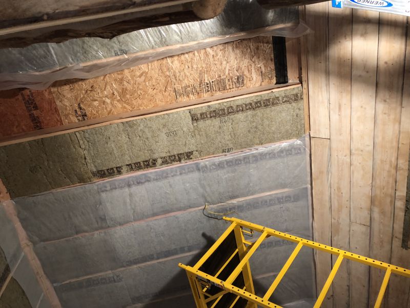

I have a log cabin that went uninsulated for quite awhile. It was impossible to keep it warm with a 40,000 BTU propane stove. All the heat went up and out the roof. Last year we got spray foam in the floor and roof. Now at 17F we are toasty warm. However, it is $35 per day for the propane. We could not get insured because we are off the main road if we had a wood stove. This cost keeps us from spending as much time as we would like at our cabin in the winter. As far as staining the logs. Call the people at Perma Chink. Their products are superior. They are log specialists and will be able to answer any questions you have. Good luck. Looking forward to some photos of your log cabin. We love photos here.

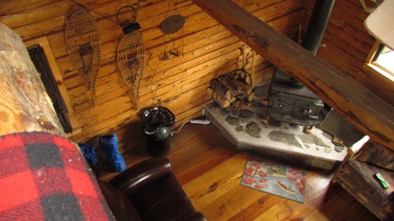

Why isn't the stove up to code? It appears to be a Timberline wood stove with a 8" pipe. Those stoves are heavy and burn well.

Quoting: AKfisher Why isn't the stove up to code? It appears to be a Timberline wood stove with a 8" pipe. Those stoves are heavy and burn well.
My insurance company said they will not give me insurance with that stove as it is out of date. It does burn well.. Given that I was able to use a piece of land I inherited to get this cabin, I don't have any actual cash in it so my idea was to use a small nest egg to buy an up to date stove and not have any more fights with the building dept and the insurance company. Given that there is no paperwork on this stove, they won't guarantee the clearances. (I seem to have a penchant for fighting with building departments.). Do you think that exterior is redeemable with a cleaning and a staining? I personally like the look of a dark stained cabin on the exterior. Curious how I can better clean the interior walls. I do own a steam cleaner and this place has electric. I wondered about just giving it a blast of steam in the spring when it is warmer. I will post the pictures here. Thank you for being so kind and offering advice. front porch

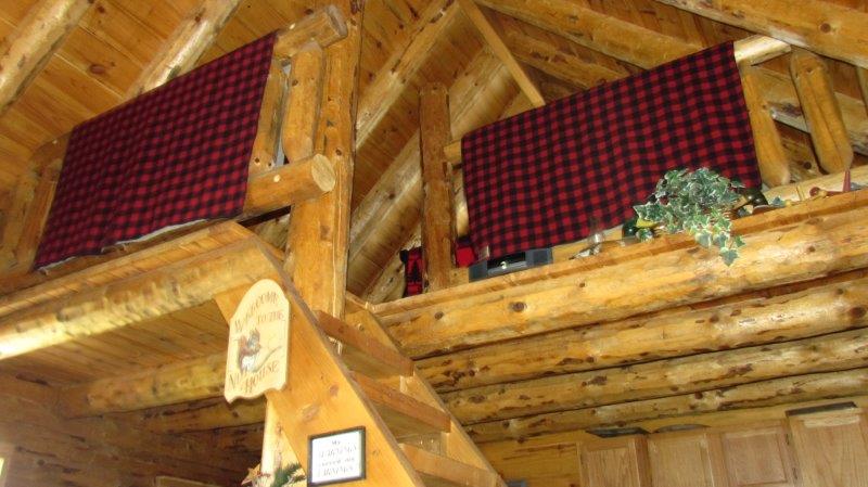

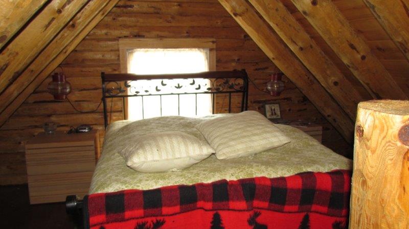

|  cabin from above
|  cabin loft walls
|  cabin loft

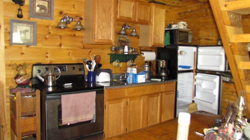

A few more photos. These photos are all of the cabin before I own it. I am kind of a minimalist so this will be much more sparsely decorated. I may also remove the upper cabinets in the kitchen and just put up simple shelving to make the room a bit bigger feeling. the kitchen (before I own it)
|  view of cabin from entry

Ive done fiberglass batts under the floor with 1/2" OSB nailed up under the floor joists, it made a huge difference. I also skirted under the walls to the ground which also helps.
