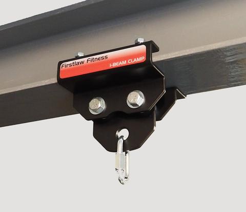

 You could mount a small I-Beam to the underside of the ceiling joists running from the front of the boathouse to the back.  On each I-Beam would be mounted two trolleys, fitted with either a sling or a simple pulley system.  See the attached photo for an example of a trolley on an I-Beam.
 You approach the open door of the boathouse with a canoe and fit the bow end into the sling of the far trolley.  Begin pushing the canoe into the boathouse until you're able to slip the sling onto the stern end of the canoe.  You'll need two people and you'll still have to lift it up but you won't be reaching over the ski boat or the row boat.

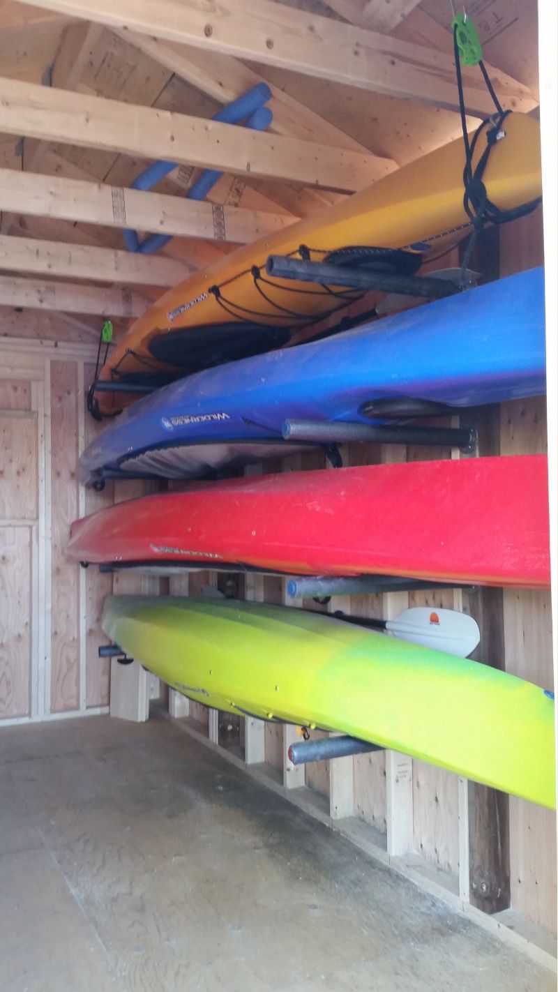

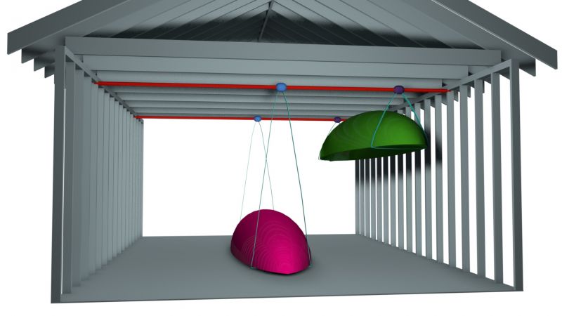

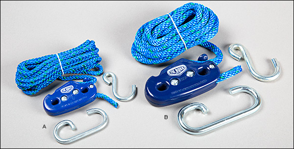

 There's another way to do it, if you have access to the centre of the boat shed.  Run two pipes width-wise and then run trolleys with pulleys off of that.  I use something called a Tie Boss.  Wrap slings around the canoe at either end and then haul it up using the Tie Bosses.  Now, push the trolley off to one side.  At this point you could have brackets mounted to the walls that you lower the canoe onto.  Then, use the trolleys to pick up the second canoe.  I use 1" pipes mounted to flanges on the wall to support kayaks in my boat shed.

 Quoting: Absolutely There's another way to do it, if you have access to the centre of the boat shed. Run two pipes width-wise and then run trolleys with pulleys off of that.
 Your sketch with the cross rails is something I’d considered but dumb me was only thinking about a short tail on one half.
 Only in looking at your mock-up did I realize that running them right across the full width of the building would let me roll a canoe or two either way. So they could maybe hang over the ski boat as well!
