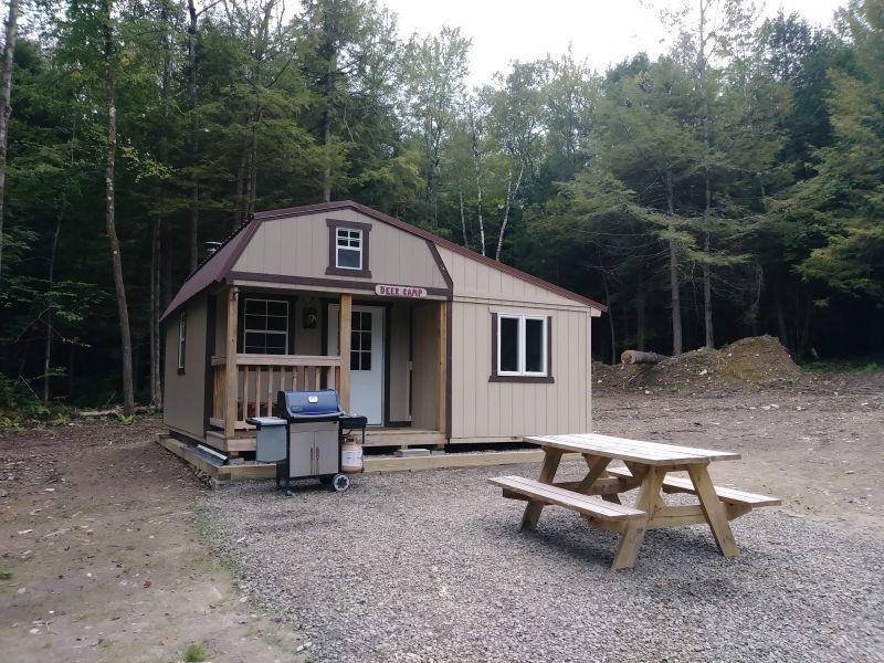

I bought 10x20 cabin on skids from Amish and it is framed almost like a house. I insulated the walls and ceiling. The floor is not insulated but for right now I have some carpet. I set it on 8 inches of stone and so far no problems. I upgraded the floor to 2x6 and 3/4 plywood. I'm located near Oneonta NY and the town inspected it and no problems. I said the purpose is a hunting camp. Since then I added 8x20 to it so the whole thing is 18x20. I do see minor heaving in winter but all the windows open and close no problem. Only the entry door have minor problem, nothing I cant live with. The only thing I still have to do is the windows, they give you single pane and they sweat in winter causing moisture problem. I had this cabin since 2016 and dont see any problems with it. The only reason I went with setup like that is money, it was cheap and fast. If I was buying another land I would probably do the same thing only different style and I would insulate the floor. Before and after the addition pictures. Im still bot done with painting and few details inside.

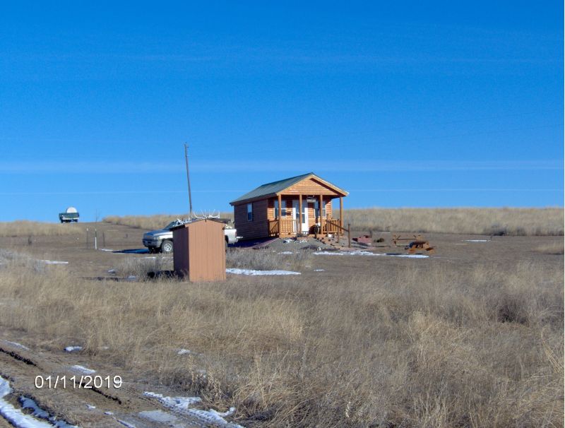

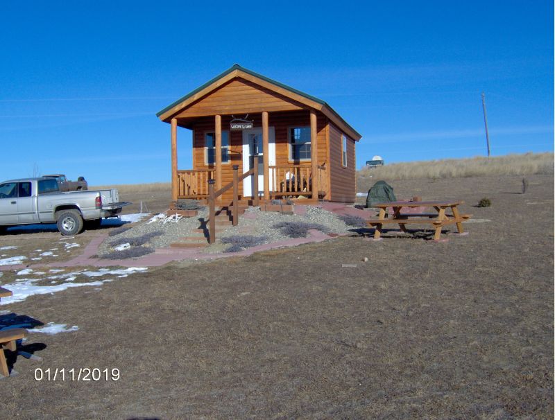

https://www.pinkhillcabins.us/
I bought my 14X26 from this outfit.
Fully insulated and electrical ready.
Sight prepped and delivered for free.
Pinkhillcabin
Pinkhillcabin
Pinkhill
Pinkhill

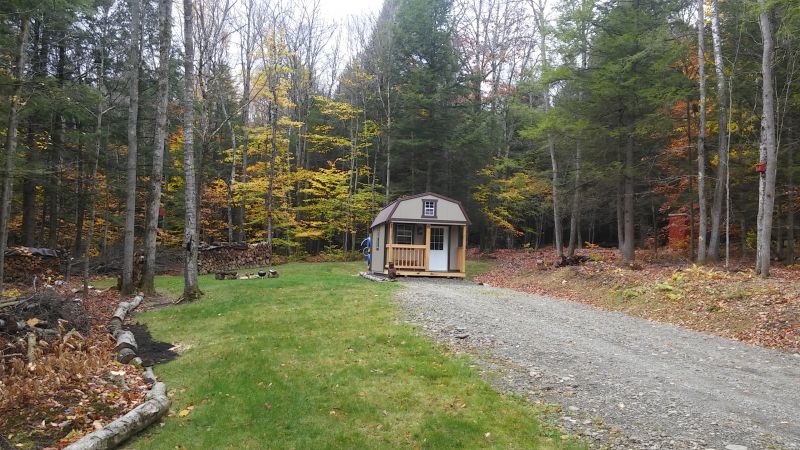

I happen to sell similar structures 8x8 up to 16x40, people buy them for all kinds of uses. I have a 10x20 repo that I reconfigured to my liking, sprayfoam insulated the floor joists to the rafters, and ran pine tongue and groove inside. I placed it on my land in the Adirondack region on NY, and thats the reason im perusing this forum. Id be happy to answer any questions about portable buildings you may have. I just joined here and dont want to get in trouble for posting my website, but if you want to check it out send a pm.
