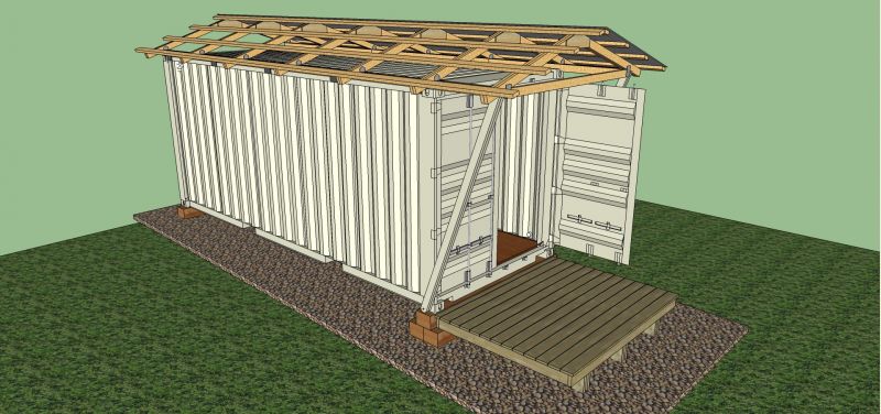

Here are my current plans for a container roof. It's more of a pole barn style with rafters, purlins, and steel panels - pretty much the same as my container cabin. I also plan on not enclosing it, which I'm hoping doesn't attract too many pests like birds and wasps.

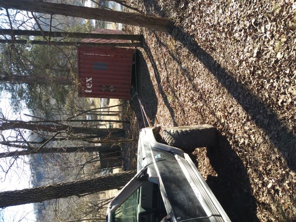

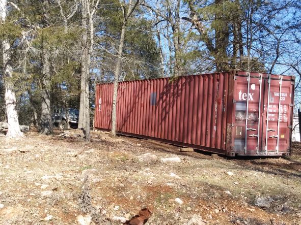

I'm fighting to drag mine up into the woods now.. Being a "one man show" makes for slow progress..
# Posted: 29 Mar 2022 11:30am
Use a tractor?
Asher
# Posted: 30 Mar 2022 11:28am - Edited by: Asher
I would love to but I am afraid my old tractor would do a back flip trying to pull that thing and I need to pull it a little bit, wiggle it between tight trees, and keep stacking logs, etc to keep it elevated off the ground so it doesn't hook on a buried boulder or flush cut stump... So far my best method is anchoring my jeep to a tree and using the 9k winch, but it was enough to break the winch cable last time out, it almost stalls the winch out (even doubling the line up using a pulley)...
# Posted: 30 Mar 2022 11:44am
Beware flinging broken cables! They can kill you quick.
Imo, if you have been sorta successfully anchoring the Jeep and using the winch your tractor will do better.
As to 'flipping it', that will depend upon what place you
put the tractor end pull. The flip comes from the tractor rotating at the rear axle with a rear hook-up. Hook farther forward and it keeps the front end down.
That said, I grew up on a farm and have had a front come up more than a few times, never a flip. Be ready to cutch it and the front comes right down. We did do some heavy pulls over some distance with the front off the ground too, scary the first time for sure.
# Posted: 30 Mar 2022 11:53am
I got mine up my steep driveway and around the trees. Had a friend in a truck in front pulling and me behind in a tractor pushing. Being able to push the back sideways was a big help getting through the trees.
Asher
# Posted: 30 Mar 2022 11:56am - Edited by: Asher
Yes thanks.. yep always keep clear of those cables (use the wireless remote and stand out of the kill zone). This one broke and sent the hook and d ring into the bumper of the truck near by, denting it in about 4inches and almost taking out the A/C condenser, air-charge cooler, and radiator (had to fish the hook out from between them).. If I had a second capable hand I would put the bobcat on the back end with the forks and try to lift and push a little bit... But again, doing things solo, adds about 4x's the amount of time to get things done.
I think the other thing adding to the fight is that this is a 40ft'er.. I tried using my hi-lift jack to raise one side and get a sliding log under there. I had my entire 230lb weight on the handle and still didn't lift the container. I was waiting for the shear pin on the jack to pop...
The next interesting challenge is going to be leveling it once I get it in place.. I am thinking using the bobcat putting as much lift in it as possible and then adding the hi-lift.. until I can get enough room to get a 20ton bottle jack in there...
