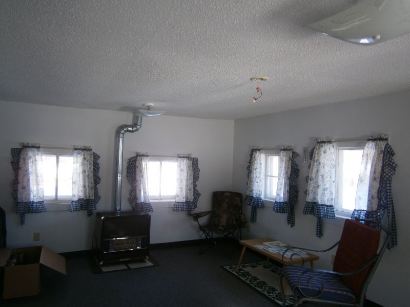

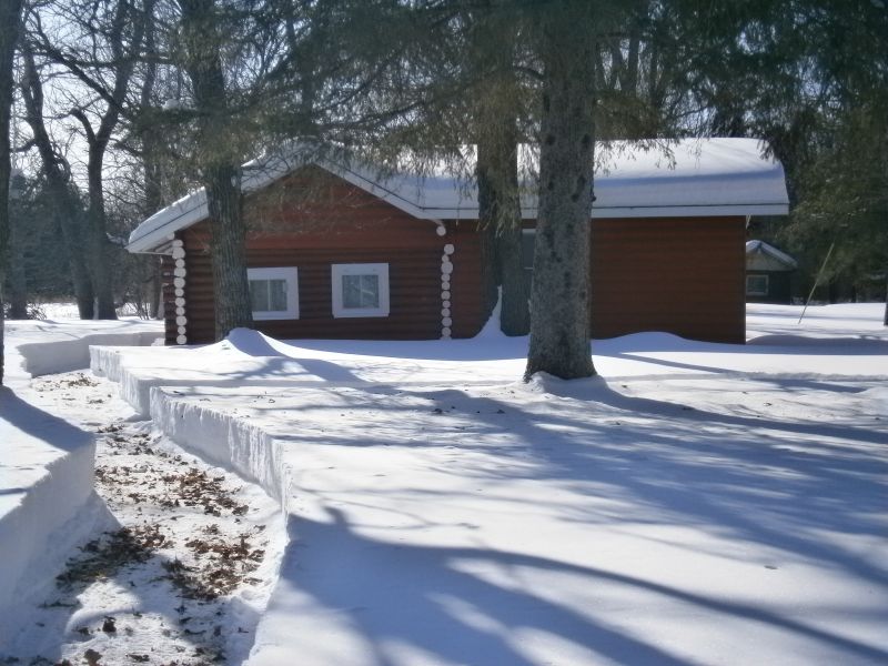

My wife and I just bought this little gem on a river in northern Minnesota, gonna start by removing the popcorn ceiling in the log part and go to a vaulted ceiling..
Nate R
# Posted: 14 Apr 2019 10:25pm
Nice, congrats!
How much land? How close to the river?

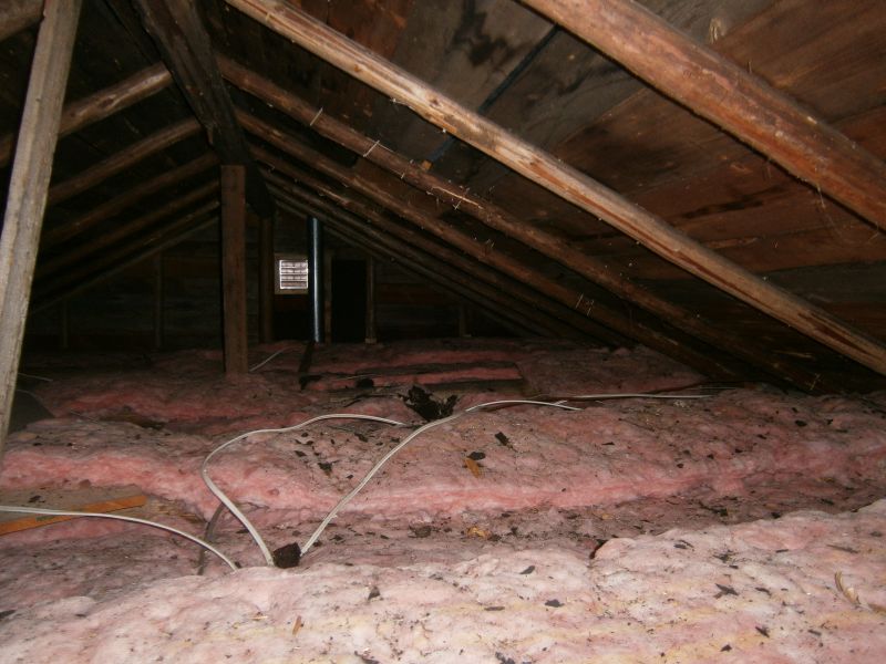

# Posted: 14 Apr 2019 10:28pm
Caution, lots of popcorn ceiling has asbestos in it.
dixie53
# Posted: 14 Apr 2019 10:46pm
Nate, 2.5 acres and about 25 feet from river.. Toyota, I don't think the ceiling is very old but i'll be careful..
# Posted: 15 Apr 2019 07:51pm
Dixie, if there is any doubt, you can have a sample tested, but you might not want to draw attention. A sprayer bottle fill with water, you can mist the area you are scraping, should be fine. But if its not old as you mention, you are probably fine

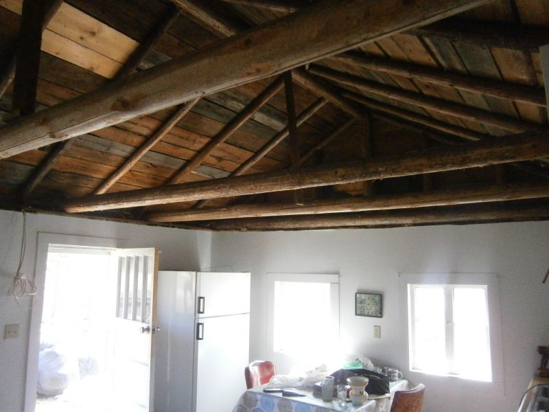

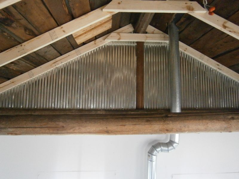

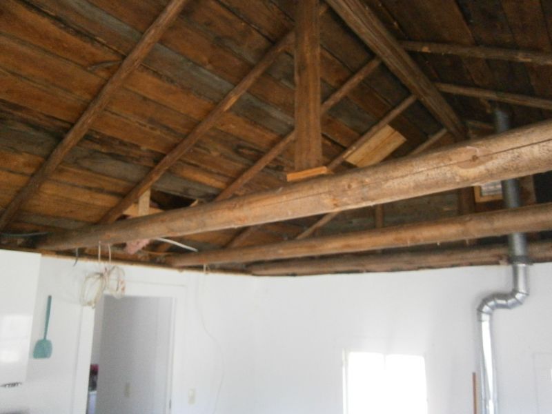

# Posted: 21 Apr 2019 10:47pm
Got started this weekend, not as nice as I hoped so I'm framing out to do t and g pine and tin on the ends..

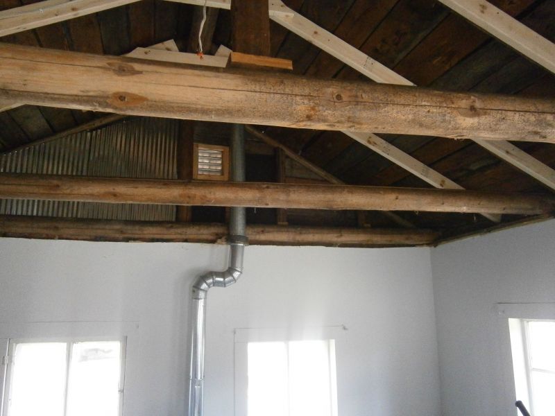

dixie53
# Posted: 21 Apr 2019 10:49pm
More pics..
# Posted: 25 Apr 2019 03:10pm - Edited by: toyota_mdt_tech
Dixie, I cant tell, but your stove pipe doesn't appear to have the special class A stuff from ceiling to outside. It looks like galvie metal pipe all the way up.
You will want a support box at ceiling and the good class A from that point up, including through the roof.
Work is looking good. I think what you are doing is better in the end. Safer, solid etc.
