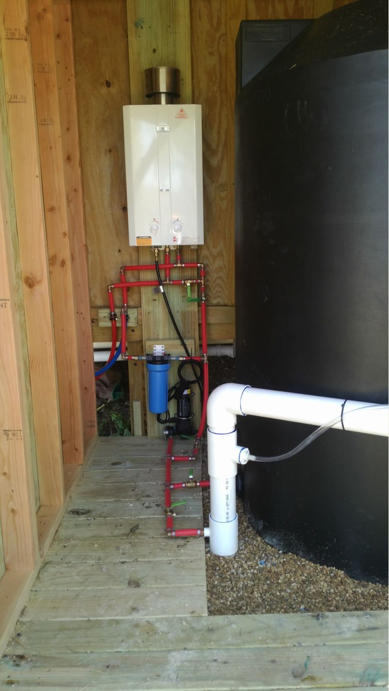

I have an Eccotemp L5. May til November its fed from my outside rain barrels. Once December arrives and freezing temperatures, I drain down everything and run RV antifreeze through it. When I arrive during the cold winter, i melt snow and ice in a big stainless tank on the woodstove and pump it up to my inside tank. When I leave, I drain it down and run RV antifreeze once again. Works great so far.
Shower
Shower
Inside tank
Inside tank
