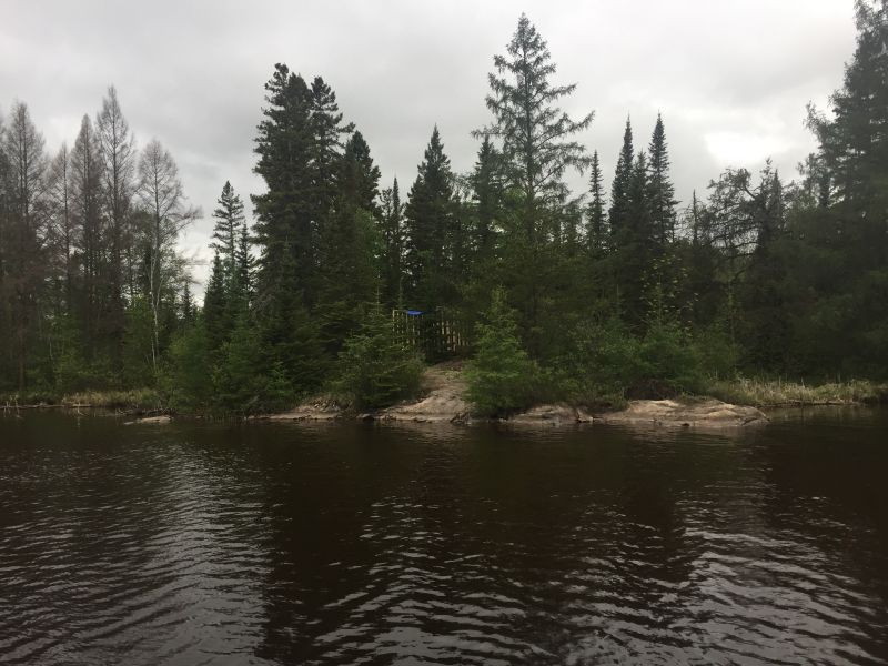

This is basically the land I’m working with

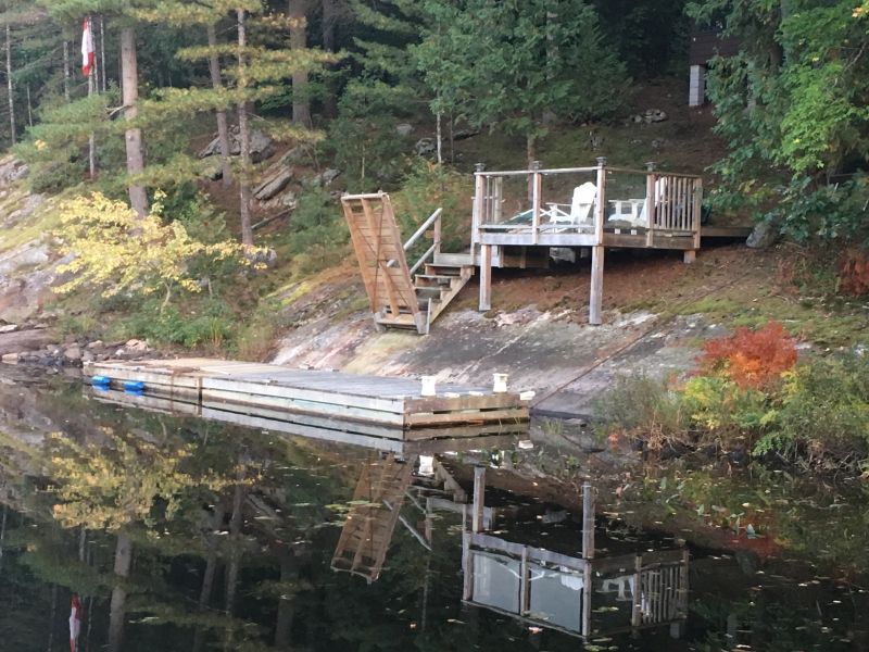

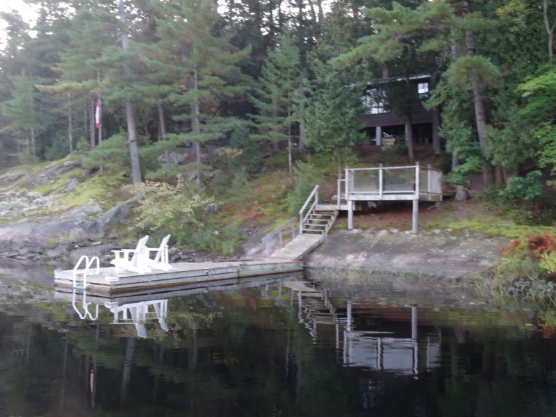

I don't know if it helps you but I've attached a picture of my setup. I'm on a river where the water level fluctuates by about 4 feet or so. So I've got a floating part attached to a gangplank then attached to a stationary part on shore. The deck part has brackets drilled and epoxied into the bedrock. The picture has the dock in the winter configuration with the floating part detached and chained to the shore to move with the ice breakup.
Another thing, if you have a floating part don't use blue Styrofoam (or other types I'd guess) for flotation. I've had otters tear my floats apart and it's sinking in one corner and sent a mess of chips floating down the river.

If it was me, I'd drill into the rock. I'm sure some of the other guys here could advise you better. You could use a hammer drill connected to a generator or rent a rock drill. My dock came the way it is with the property so I didn't install it. I found another picture (a bit blurry) with the floating section connected.

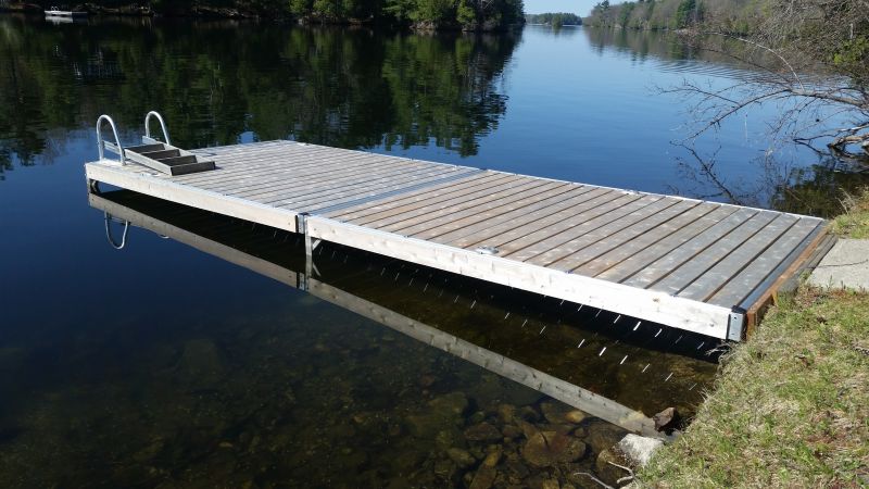

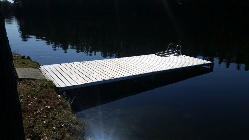

# Posted: 18 Jun 2019 05:21pm - Edited by: Absolutely
My dock goes out 20', in two 10' x 8' sections. It rests on feet in the mud and it's about 7' deep at the end.
When we bought our island we poured a concrete pad on shore and stuck a couple of bolts out of the wet concrete. We attached pressure treated boards to these bolts using nuts and washers. Originally we used hinges to attach the first section of fixed dock to shore but a couple of years ago we upgraded to the aluminum dock shown below.
In your situation I would drill into the rock and pin the dock. Alternatively you could form a concrete pad up, held in place with pins drilled into the rock. 20180509_093158.jpg
