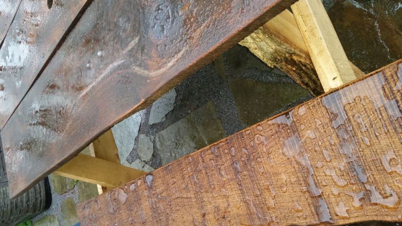

I can tell you that you will not find a quality exterior stain at a big box store. I would also stay away from anything water based.
This is a rough cut picnic table i stained with TWP 1500 dark oak. You can see the water pooling on the Ash seat and bot so much on the pine top. Remember these are completly flat surfaces so some water absorbed is normal. This stuff went on very easily and you can re apply if needed. This is two coats and in the pic has been outside for about a month.
For your needs i would stay with something log siding specific. No deck stain and no furniture stain. Oil based is what you want, something that cleans up with mineral spirits.
