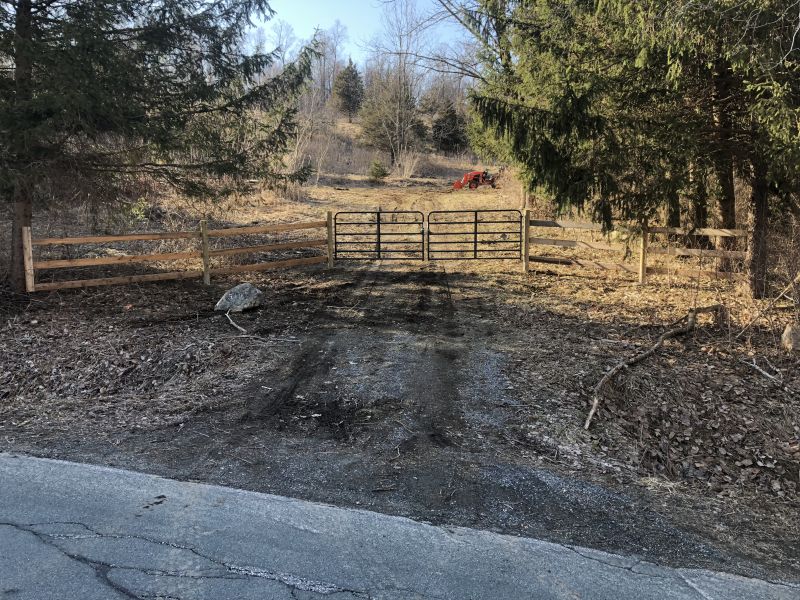

My humble gate:
Trying to blend in

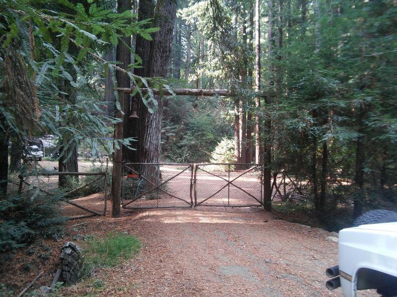

# Posted: 1 Jul 2019 02:15pm
It does blend it quite well. How to tou get the ferns to pop back up?

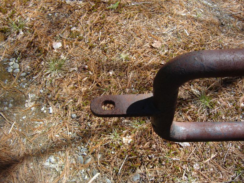

This is how my gate is secured, requires some welding skills....I put nuts onto the lock so you can't use bolt cutters and if you can manage to get a grinder in there the wheel jams up on the nuts....Winter I just dip the lock 100% antifreeze and it will never freeze up....The lock goes through a hole drilled in the pin.

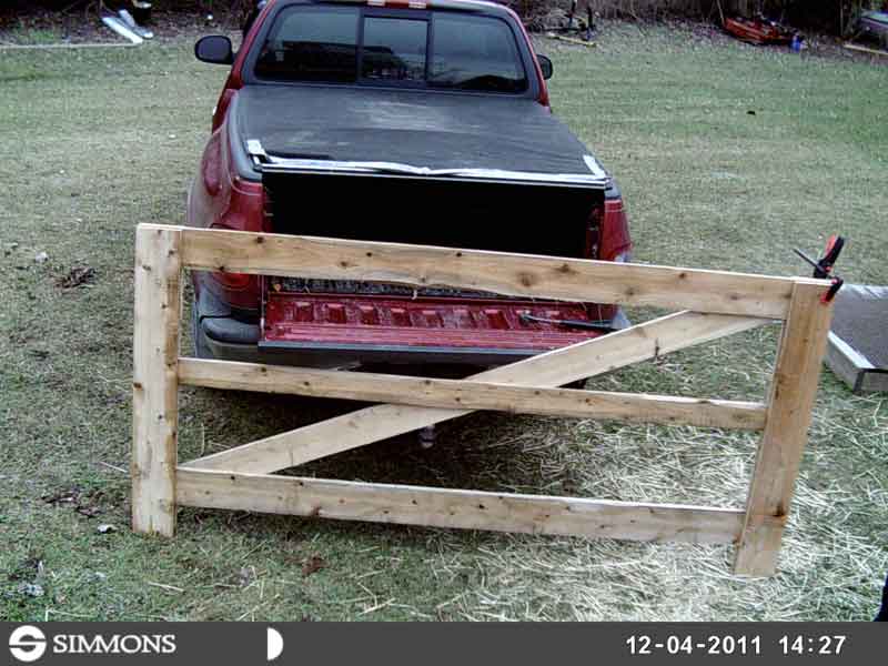

I have a two gate. Here's the first one under construction. I sort of slammed 'em together just before heading south for the winter.
Put cedar posts (8" roughly) into heavy clay soil. The one is solid. THe other moves a bit in the winter. But the gate still opens and closes. Mostly its the soil rising as it freezes catching the underside.
I really should get a pic of the entrance. Hmm.

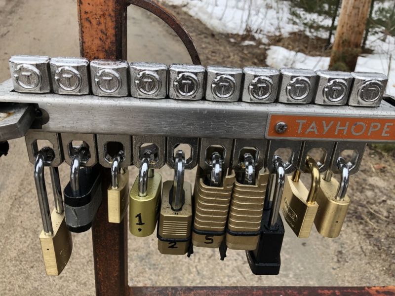

Not really relate to the structure of the gate but the locking of the gate. My cabin is on a shared private road and locks have always been a nightmare, but we installed a new Tayhope multilock system and it's been great. Really easy to use. Probably not very secure, but better than the old daisy chain of locks that someone cutoff and threw away.
# Posted: 25 Oct 2019 11:52am - Edited by: KinAlberta
Now THAT is interesting.
Sorry, but that does look like it creates a weakest-link problem. For instance that long thin shackle lock on the left. Maybe tie a bag of nuts to the gate for owners to use.
Also, you can sure tell who had the good stuff. Or the worst insurance.
We have our keyed padlock and then a really cheap wordlock combo. I interlink them so either works but it seems others have a harder time with the concept.
So I still always carry the key to it too.

Quoting: KinAlberta Sorry, but that does look like it creates a weakest-link problem.
The gate really only keeps the unmotivated riff-raff out but I feel like it's better than nothing. The nice thing about this setup is that if they cut one lock off they can get in, but we all don't lose our locks like the daisy-chain approach. It took 6 months of having the gate unlocked to coordinate getting this new setup.

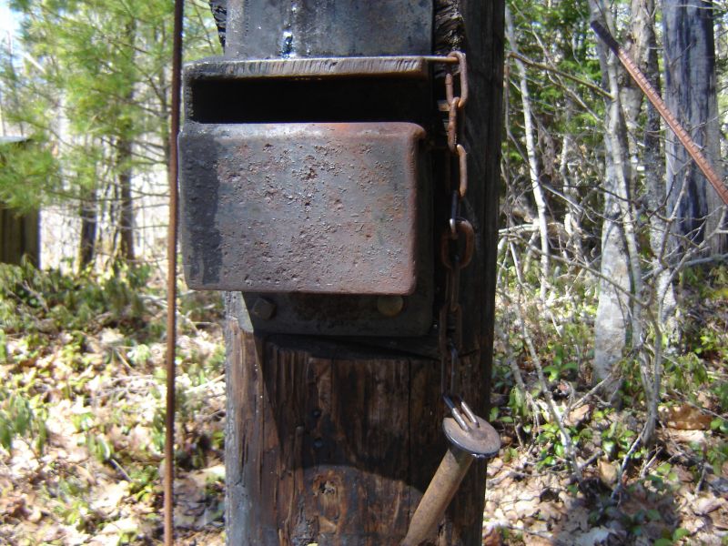

The USFS has some gate lock enclosures that make it impossible to cut a lock with anything short of an acetylene torch. Easier to cut the gate metal than the lock and they usually use heavy wall rectangular or square steel tubing for the gate itself. They can be a PITA if one has to travel through frequently.
Here's a link to one of the gates on a ranch road here in NM. It is instructions on how to use the gate. I use the same thing on gates around my property. This is NOT me, but they are neighbors.
And here's a similar lock enclosure but without some of the intricacy in the one in the link. The steel box only lets you reach up with the key, insert and unlock, then remove the lock and then pull the large pin. The pin size discourages most from trying to cut it. I have a couple like that too.
