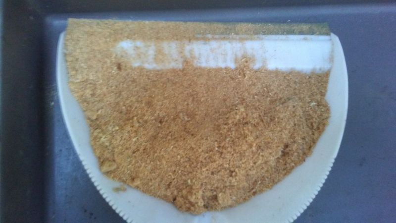

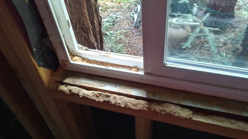

Built a shed last year, this morning I noticed one window cracked open and this wood dust. Insects or leftover saw dust?

It could be carpenter ants but that's a lot of dust. Carpenter ants can't eat solid wood. They need something compromised by moisture. The window kind of fits the bill if there a hidden leak in flashing or a lot of condensation occurring. If it is ants you will clean up dust and more will accumulate.
If it is ants, don't spray them. You just kill soldiers and the queen will move. You need to get the queen. Use a bait that slow acting that they will feed the queen. That way the colony will disappear but you still have to be wary if there's another queen waiting to hatch. And any water damage needs to be fixed.

And don't put the bait inside, it will just attract more inside. I used the Terro 1 oz bait traps that you pin to the ground outside of my cabin, set some firewood over it to keep the coons out. I had carpenter ants in my cabin and after two weeks none inside nor around the outside. I think it killed the whole colony.

Yep Carpenter ants. I have used BASF 396153 Advance Granular Carpenter Ant Bait and it works. Regular ant bait does not work. Whatever you use must state clearly that it is effective on carpenter ants.
FYI, they do not eat wood. They tunnel to make a home, galleries to lay eggs and hatch more ants.

Crap. Where do I look for the wood damage? This is the only spot in the shed, does it have anything to do with the window being left open? I don't think there has been any dampness since last winter, and it was closed then I believe.

I wouldn't worry about the damage yet. Maybe vacuum up the debris, called frass to see if they are still active. If you see them check their antennae. Carpenter ants have bent ones, termites are straight. But that sure does look like what carpenter ants leave behind. Termites eat the wood and leave mud tunnels on surfaces. The bodies are also different in appearance.
If you have time, leave some sugary fruit out. They will be attracted and you can follow them to the nest.
You can also mix boric acid crystals with powdered sugar. The sugar powder is the bait, the boric acid will be taken back to the nest and kill them off. The product I mentioned before does work well. It is not advisable to spray them with anything as that gets them upset, they sense danger and then swarm and move to a new place, not usually all that far away and then you have to start the search all over, I learned the hard way years ago. If you see large numbers of ants with wings they are getting ready to swarm and find a new or another place. They will do that when the colony gets big enough to branch out with a new queen.
They do tend to like damp better than dry but I have seen them in plenty dry wood. Opportunists, they are.
Good luck.

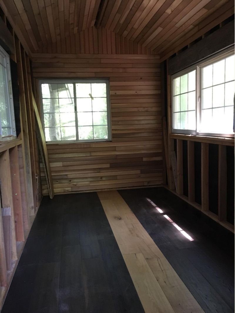

Thanks everyone. I swept and vacuumed it up today, couldn't see any obvious damage above. We'll see what develops. An out of work friend put up the cedar I had laying around back in spring. Can't smell it though, I think it's the doug fir framing.

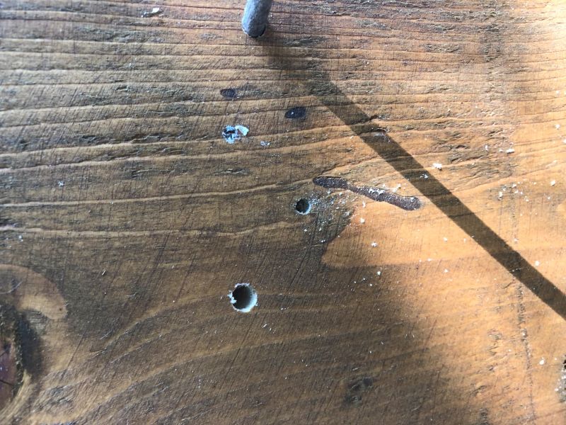

I also have some sort of wood borer. Not sure if it is carpenter ant, termite or spruce bark beetle? Didn't think the spruce bark beetle bored. anyway, here is a picture of the hole it has been making on one of my cabin posts. This is outside, counted about 8-10 holes. The sawdust collects at the bottom of the porch. Never have seen the critter though. hole is perfectly round and about 1/2" while some others are a little smaller. I am located in South Central Alaska.

AKfisher, looks like you have carpenter bee holes.
