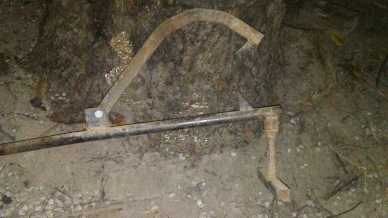

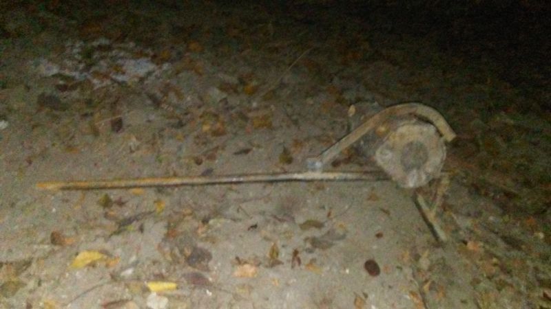

I made this out of 3/4 inch black pipe for doing what you need.
Its a cant hook with a removeable jack foot for lifting logs off the ground for bucking down to size.
You can get a cheap one off amazon for about $50 bucks.

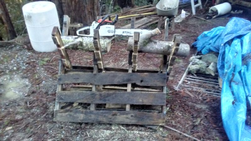

Here's a couple other ideas. I built one like the first pic out of old pallet wood. The only difference is the one I built, I put planks on the top for sliding smaller limbs.

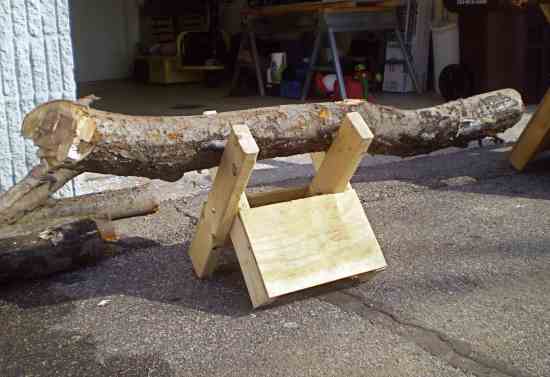

The second pic. I just found on the net. Looks like it would be easy to build and super portable.

Darz's setup looks good for occasional use.
You got that right my friend. It seems like every occasion I need to use a chainsaw. I bring this along. Lol. Which is frequently. I can't tell you how many chainsaw chains and bars this thing has saved me. The tooth I put on the long bar can be used to pry bigger logs/trees apart, if you didn't get your wedges in soon enough, and pinch your bar.
Not to mention trips to the chiropractor. 😱 The only wood you have to pick up, is the bucked to size logs.

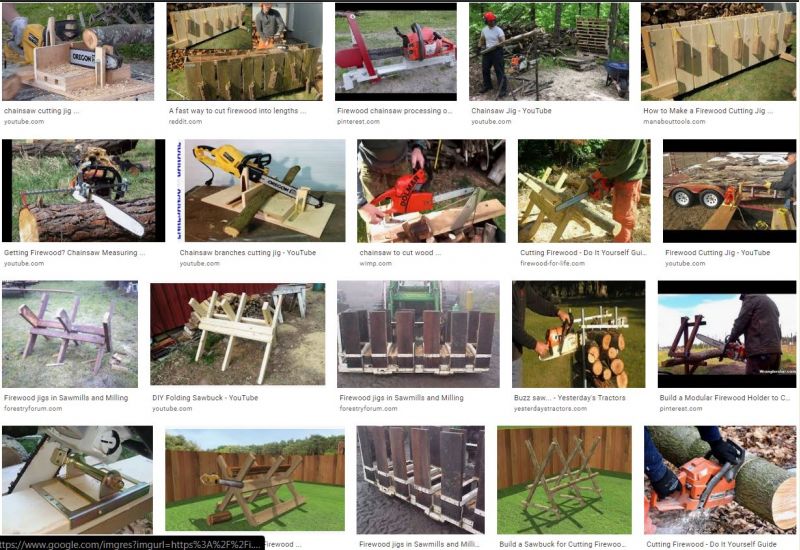

I don't see anything wrong with getting the wood off the ground where it can be safely held and cut without all the bending over of working in the dirt.
Lots and lots of jigs, homemade and commercial, on a google search.

Finally got around to making the pallet jig. Oh man, this works so well I may have to make one out of nicer pallets! Besides getting the wood up where ypu don't have to bend over, you can buzz right through full bore and just hit the pallet wood below.
Thanks Darz5150!
# Posted: 26 Dec 2019 06:53pm
Bingo! My friend!👍
# Posted: 27 Dec 2019 08:07am
Jigs like this make you lift the logs one extra time. This is why any saw that I'm bucking firewood with has at least a 20in bar, for reach.
If it's small enough to lift onto that jig then it's small enough to kick upon to the rest of the logs and cut.

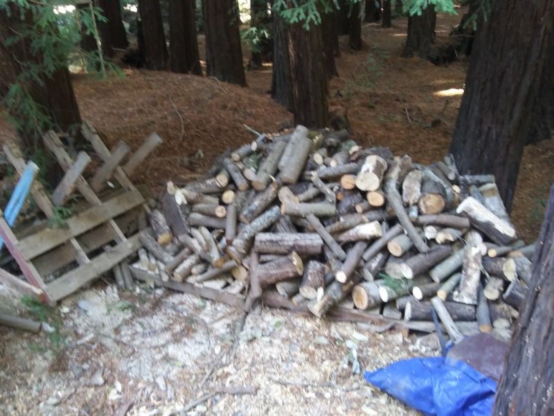

Hey Darz, been bucking the trees I cleared off my hillside for defensible space, all small stuff but added up to a pretty good pile. After cutting some on the wood pile, holding it with my foot, using the saw dogs, flipping it over to finish cut, I pulled out the pallet jig. Made a video to show a friend. Love it!
https://www.youtube.com/shorts/6rxDwh4v65k
# Posted: 2 Oct 2021 09:42am
Hey Paulz. Glad to hear it's helping you out! It really does make it safer and easier cutting up the smaller wood. 👍
