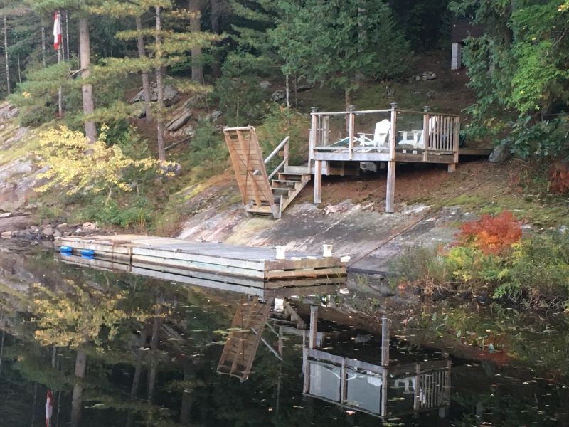

# Posted: 14 Nov 2019 07:59
Grizz, my cabin is on a river and we have a floating dock. I use a winch connected to a tree to raise my gangplank like a drawbridge. Then I just have a couple of long chains that I connect to the corners of the dock and back to some trees. This is the way that a number of the cottage owners in my area have done it for years. It allows the dock to move with the ice a bit I guess. Although I watched spring break up this year and I don't think that my dock would've been harmed had I just left it in place. Our river doesn't have much current but I'm guessing if it was windy the ice could have some power.
Dock - Winter Position

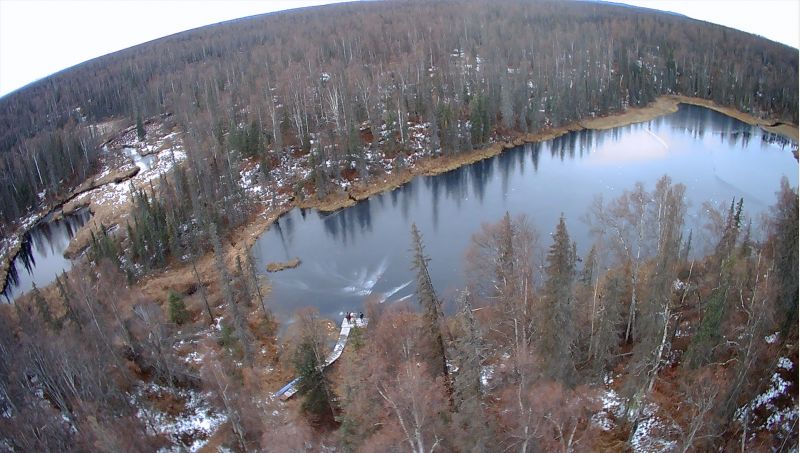

# Posted: 14 Nov 2019 16:14 - Edited by: NorthRick
Our dock is not a floating one but on metal posts driven into the lake bottom. The lake ice can get over 3 feet thick. The lake level drops through the winter and the first winter after the dock was constructed, the ice tore off the diagonal supports that extended below the water line. The dock seems sturdy enough without them so I did not replace them and have had no further issues with ice damage.
Below is a recent photo of the dock with ice on the lake.
Dock and ice
Dock and ice
