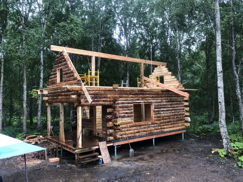

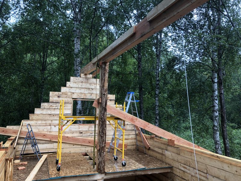

I looks like you would want a scissor truss, that way you can still have your cathedral ceiling but still have them stamped (engineered). Or you can run a ridge beam and hang rafters. You run into issues with clear span with the ridge beam though.

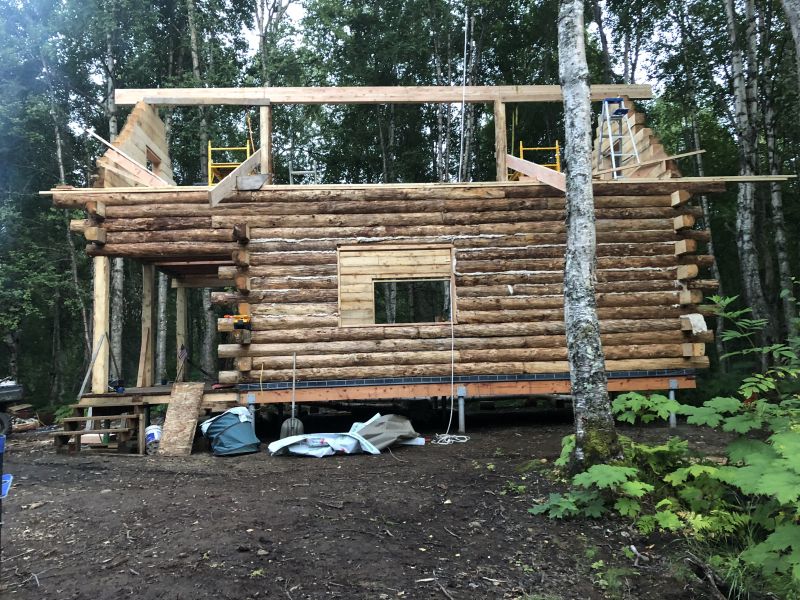

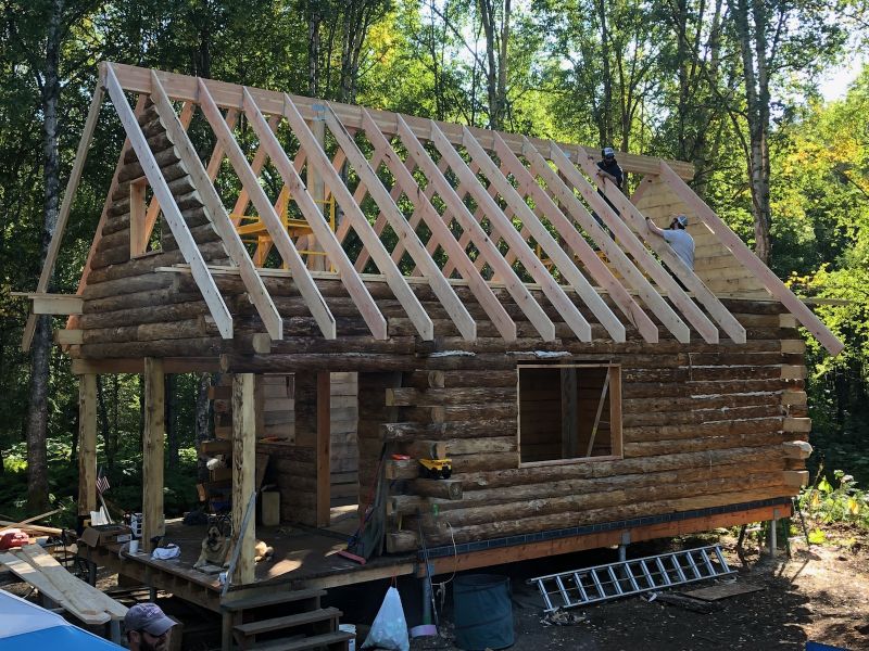

I have a 16x32 cathedral ceiling with two posts, one down to a wall and one down to the floor. The beam is a 5x12" glulam. Heavy and expensive. The rafters are 2x10's, 15' long. Insulation is the rockwool cathedral ceiling r30 insulation, 8" thick to give me 1.5" airspace for venting.
AKfisher

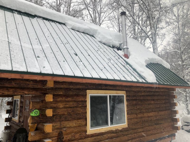

# Posted: 11 Feb 2020 05:19pm - Edited by: AKfisher
Picture from this weekend, 1.5' sliding off the roof.

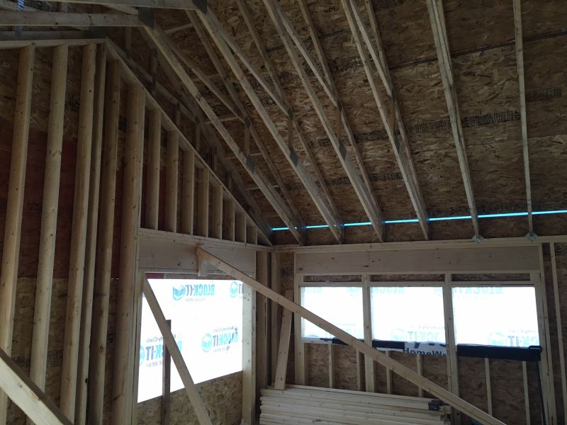

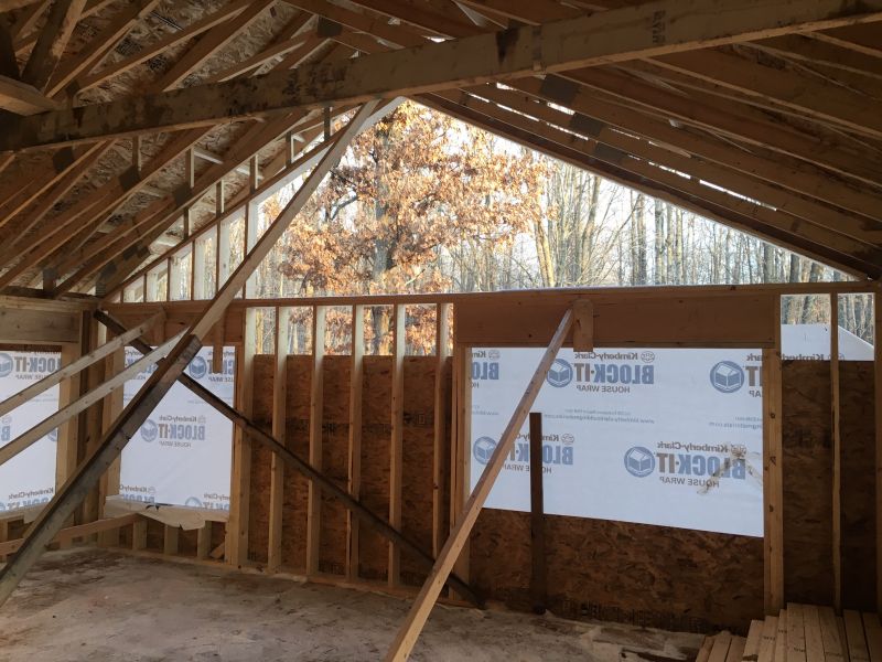

I dont think bottom cord would hinder, they can literally design whatever height heel you want on the truss, additional you could make the wall height higher if you had to, to accommodate the loft and then put the truss on the top cord from there at whatever pitch you want. They can literally design any truss you can imagine. Your plan is very simple when you compare it to super complex roof systems in large houses, Im talking 5-6k sq ft or more with various elevations, cathedral ceilings, dormers, tray ceilings etc. I mean when you really start to look at the roof systems of some of the really really large houses, its mind boggling...a simple open concept is a walk in the park compared to those.
I've attached a couple pics of my project, where the interior vault over the living room (8/12 exterior roof, inside is 6/12 over the LR, and the rest of the house are standard trusses) those scissors I have can be whatever you want them to be and they will size accordingly to support your loads...they want your business so thats on them to do the math.
