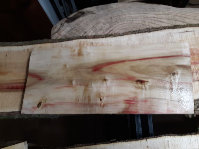

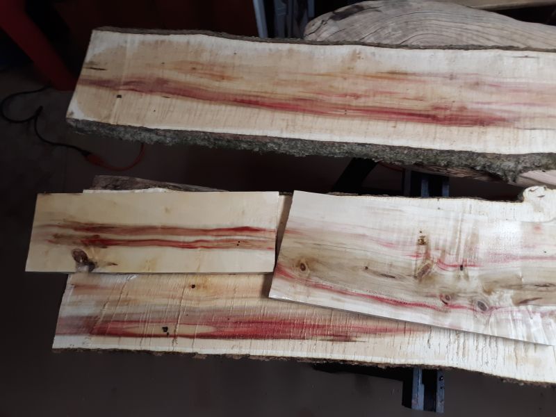

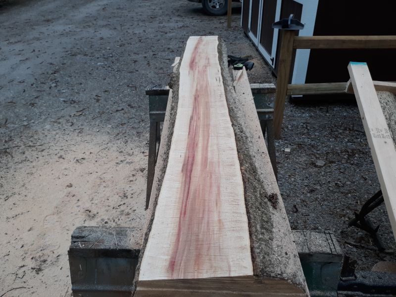

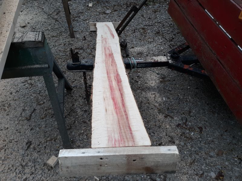

Started slabbing out this Box Elder to make cabinet doors and drawer faces for a buddy of mine. 20200412_164752.jpg
AK Seabee
# Posted: 12 Apr 2020 07:56pm
Pretty grain

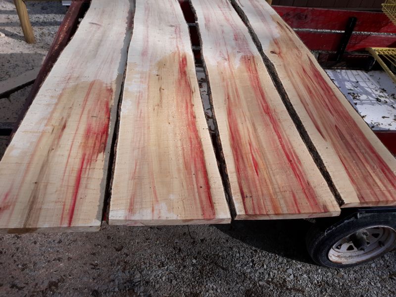

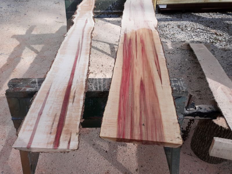

# Posted: 13 Apr 2020 05:46pm
