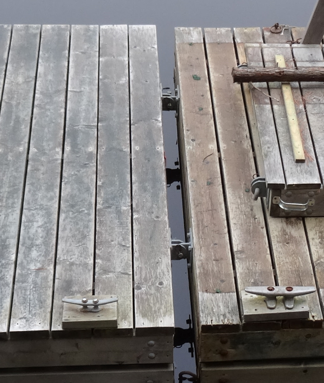

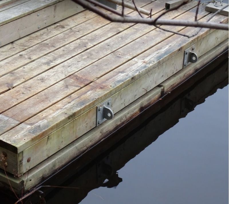

KelVarnsen
# Posted: 6 May 2020 08:07am
Quoting: MAYHEW21 Can I bolt the new section directly to the old making it ridged or should I let it pivot on a hinge?
I have a 2 part floating dock, just straight, not L-shaped. The parts are hinged and I have no trouble with it. The hinges are big, beef galvanized metal and require no maintenance. Stepping from one piece to the other is not an issue. I'd make it hinged if I were you.
I've attached a couple of pics from mine.
