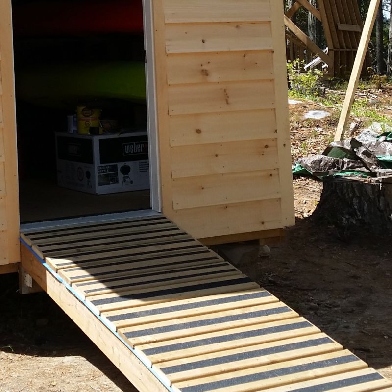

I use Lee Valley high friction tape on all of my ramps and stair treads. I scuff the wood lightly before applying and have even stained over them. You could always tack the ends down with a staple gun or roofing nails. Marine carpet glue could help too.
