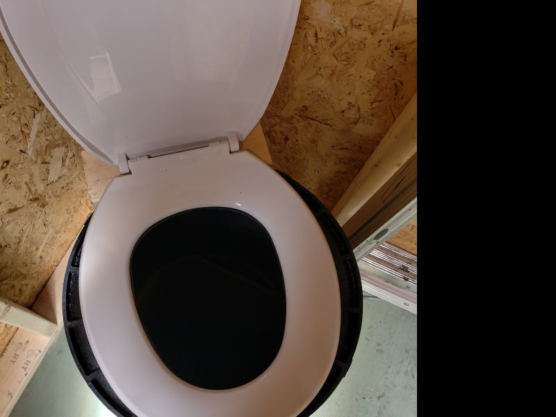

This is what I used:
https://www.homedepot.com/p/Everbilt-18-in-x-22-in-Sump-Pump-Basin-SF20/204733081
Install it upside down, cut a hole in the bottom (now the top), install a toilet seat. About $35-$40 and done.

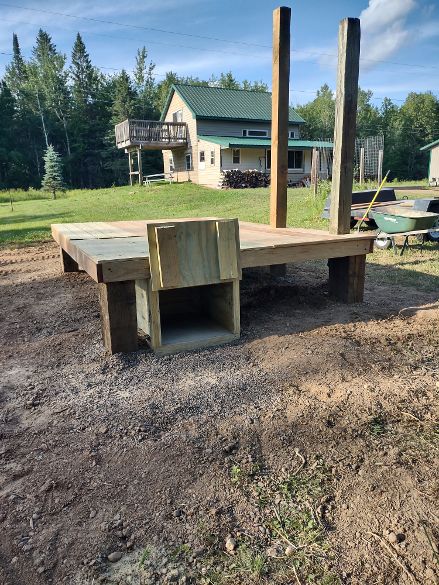

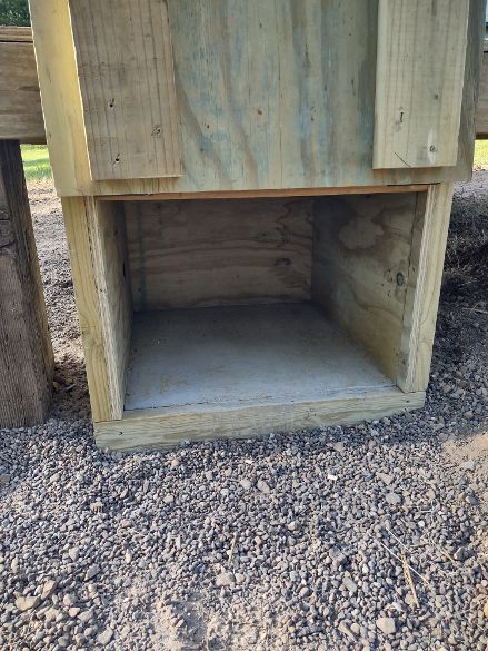

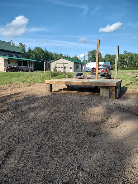

Here is my elevated platform for the new outhouse
toddchas
# Posted: 19 Jul 2022 12:07pm
I'm going to frame up the outhouse on this platform so I can have the poo drop into a shortened 55 gal. plastic drum that sits underneath that the user will cover their business with a scoop of sawdust. Above I want to install a fiberglass toilet pedestal with a pee diverter. The poo will go into a compost after several uses and return to the land after composting.

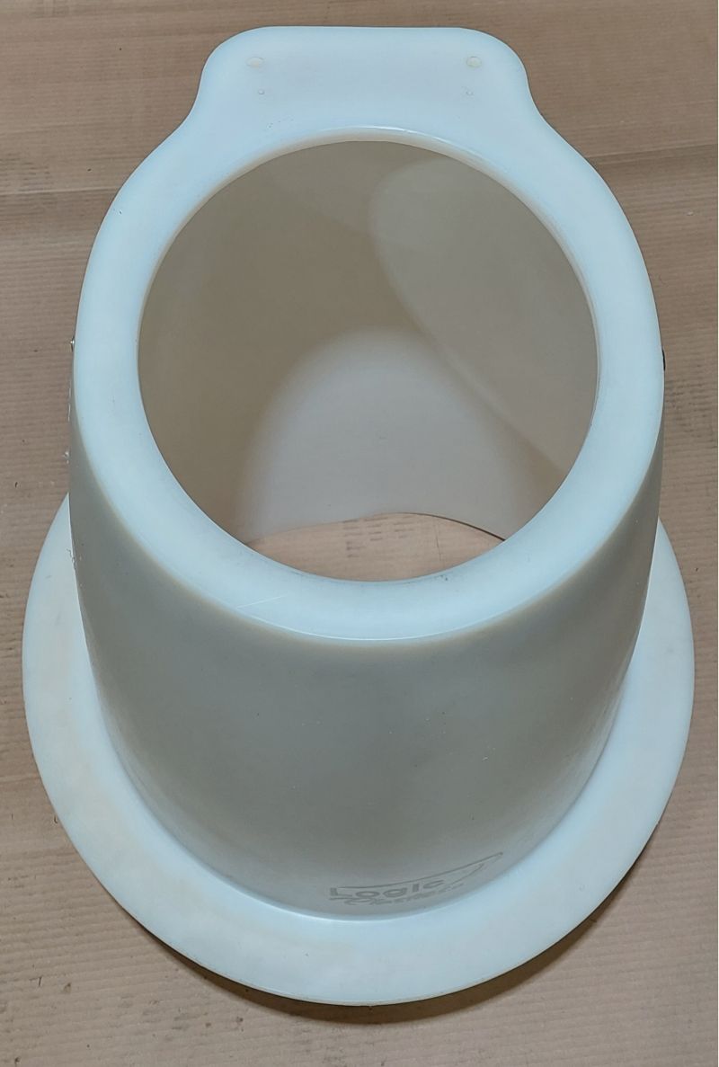

The best place to buy these is from Logic Plastics. They sell them direct in Canada and through Amazon in the states. Their quality is by far the best compared to anything out there.
Watch out for fiberglass ones. They are often rough on the inside and toilet paper and "other stuff" sticks to the rough surface. Also, other plastic toilet pedestals are not sized to fit standard toilet seats properly. The one I got from Logic Plastics is perfect in every way. Smooth, easy and somewhat self-cleaning and it fits the toilet seat nicely.
Logic Plastics toilet pedestal

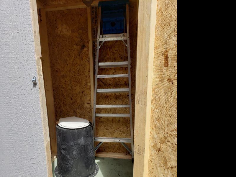

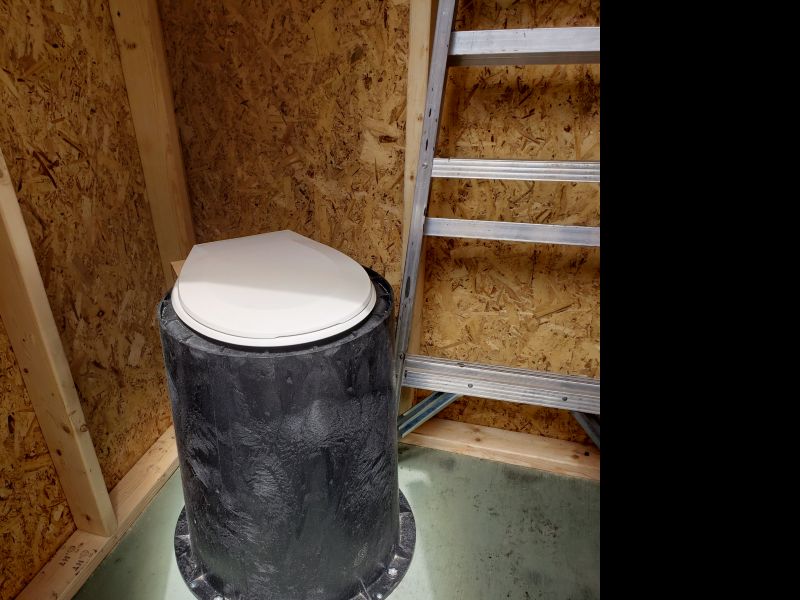

The above post is straight Spam. Expensive, yes, but these things are very difficult to even find.
Several posts up the page, NorthRick posted a great DIY idea for ay DIY'er who wants a pedestal type base for a privy. It's a Home Depot sump pump basin, turned 180 degrees and customized.
I have one at my cabin. Quite pleased. It took some hunting through the toilet seat selection to find one that had the least clearance between lid, seat and base.
If I find a photo I will post. I know I have some someplace, but it may take a little looking.

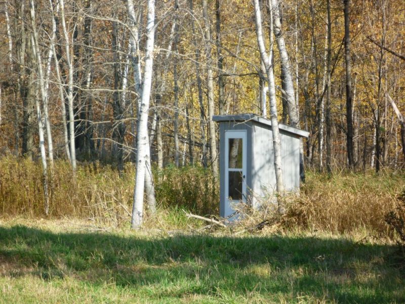

# Posted: 22 Dec 2024 04:36pm
Okay, I got lucky and found images without much trouble. I made a urine splash shield for the front inside of the interior of the pedestal. I did not want to seal the pedestal to floor joint with a caulk unless necessary as caulk would make pedestal removal more difficult if I ever had a need to remove it. So I used a 24 x 24 piece od 1/16" acrylic as a splash shield around the inside front. The acrylic sheet is dropped over the opening edge side so there is no chance of urine running down the inside face and seeping out between the pedestalto floor joint. I hope that is understood okay.
7 foot deep 3 x 3 foot pit. It'll take a while to fill. I had to build a new privy after the fire came through a few years ago. This is not as deluxe as the one that burned but I was in a hurry this time. I used the old pit to dispose of burnt debris as fill material, plus a little soil on top, so this one is all new.
