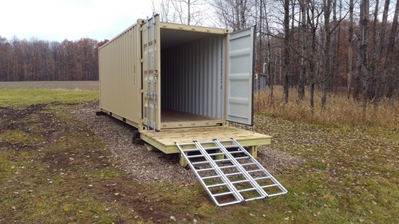

I bought a 20' shipping container. Very secure, wind and weather tight from the get go, and mostly maintenance free.

Brettny. If you do get a container, I highly recommend installing some better vents - especially if you store anything with gasoline in it. The ones I used are from containerlockbox.com, and while they are not cheap, the quality is fantastic. I installed two of them at opposite corners of my container, and they have done a great job keeping my container ventilated.

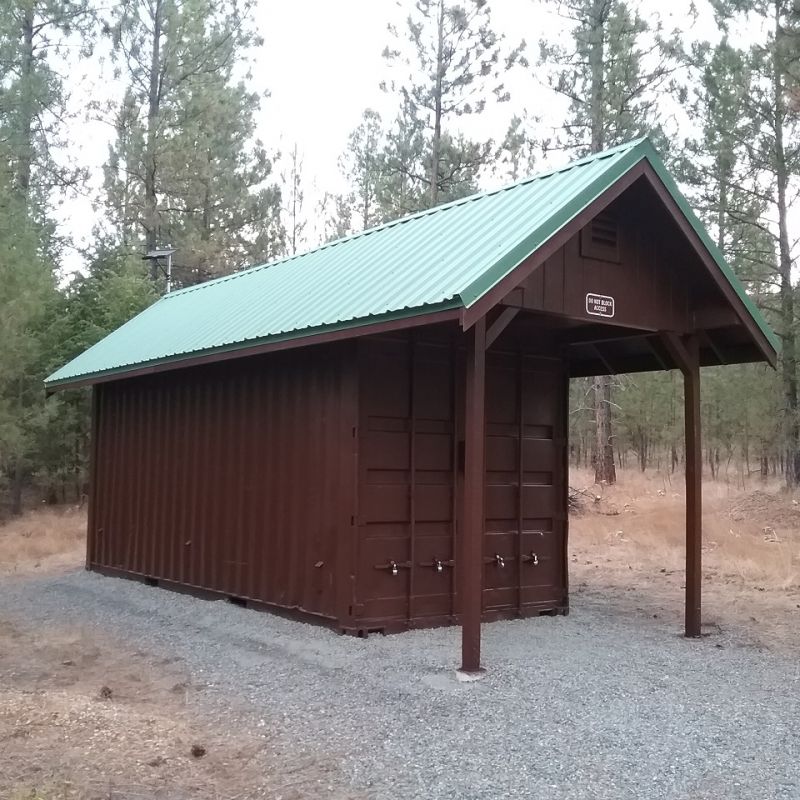

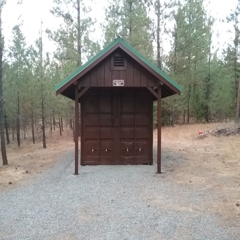

Mine takes 5, all American 7/16 hasp, one inside a lock box.
I made 6 vents, 3 on each side, zero sweat, with roof added, cool in the summer heat, can open door when it gets 3 feet of snow etc.
Roof makes is look so nice too.
