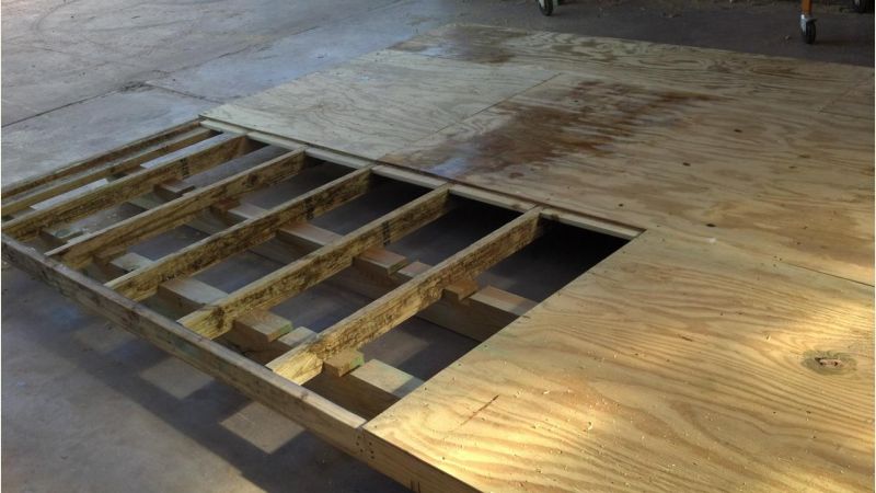

I think you might run into a problem with frost heave where the 12x12 sections would be stable but the whole 36' length could bend between the sections. This is a pic from a shed factory. The skids are bolted together and then the joists are glued into the skids making a more rigid foundation. You could make those cuts with a chain saw. Then use construction adhesive and Simpson strong ties. The concrete blocks need to be below frost depth, on gravel. Have you considered pouring concrete piers with sonotubes?

Your point plus my concern about the roof load, I think I'll stick to the skids going length wise. I'll join the skids together at their ends with 2x6's across the seams. I may also set the joists into the skids as your picture shows. I was possibly going to do that anyway to assist with leveling
