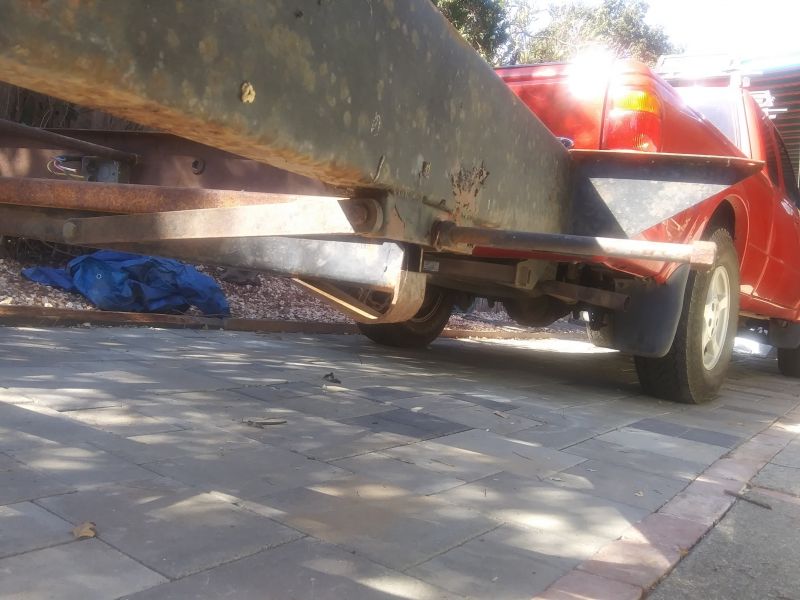

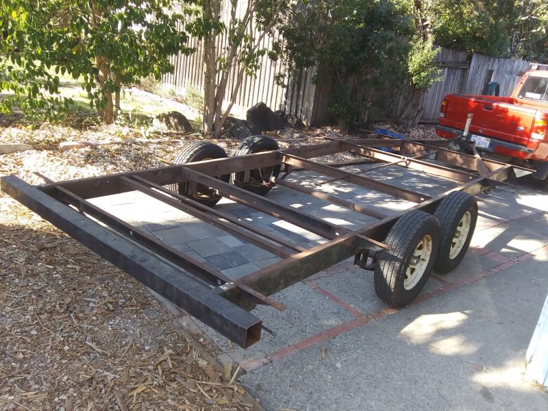

Ha, I just an hour ago picked this up. Got home from the cabin last night, guy down the road had it for sale, $200 with title, plate, current reg and brand spanking new tires with warranty. Even the deep cycle battery that was in the box is sitting at 12.7 volts!
Anyway, was a camper. Has those built in leveling jacks front and rear. I doubt they will lift the tires off the ground though, which would be best for long term as mentioned.

Only watchout is that i've built ice shanties on camper frames before and the frames tend to be built out of the thinnest material possible. So keep that in mind if your planning to put any sort of weight on there.
# Posted: 26 Oct 2020 03:54pm
Thanks! Good point. I'm planning to use it to haul my little hot rod pickup. Probably about 2,000lbs. by the time I add plywood and a tool box. The main rails are 6" box, not channel, should be plenty enough for that.
