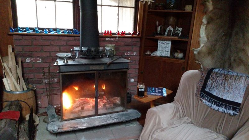

Fanman
# Posted: 19 Oct 2020 05:56pm
Mine is right under a window, no problems.

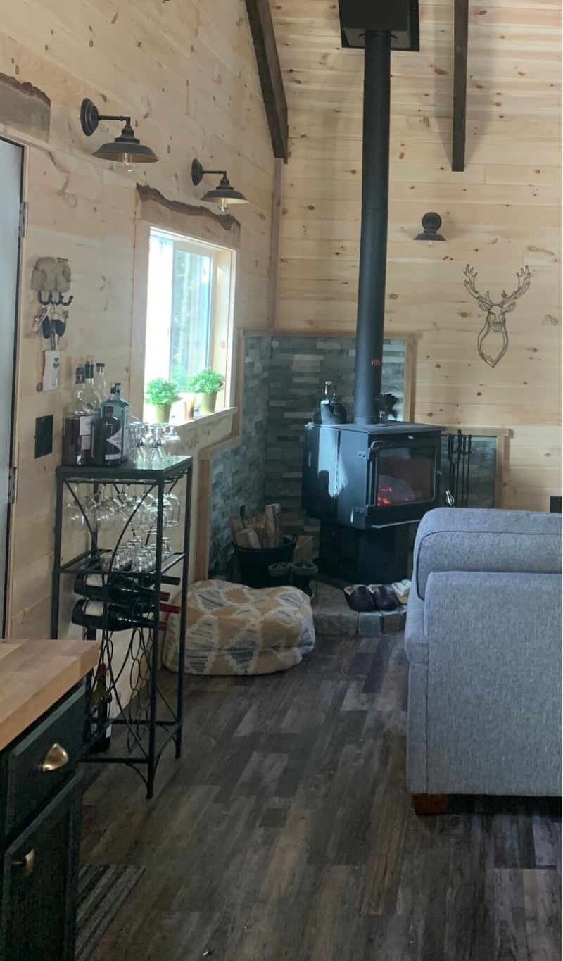

# Posted: 20 Oct 2020 02:36pm
Interesting question
January this year was the completion timeframe for my cabin - so the wood was still damp, etc
See below where my stove and 1 window is located
Mid January, we went to the cabin and it was around -15F/-26C.................so a little chilly with a lot of snow and freezing inside as well
We put the stove on and had it fully stocked and roaring for hours
We ended up with a huge crack on this window, full length of the glass pane (double paned and new window)
Got it replaced under warranty!!
But the guy did put it down to .............
Per ICC above
"........thermal shock or expansion issues when it would be very cold outside. "
Fanman

# Posted: 21 Oct 2020 08:33am
Quoting: zorro
Per ICC above
Not having enough space in the rough opening on a wet structure and drying it out with a stove could cause the framing to shrink or shift making a crack.

zorro
# Posted: 21 Oct 2020 12:45pm
I agree - the wet structure and the extreme cold, aligned with the heat from the fire - a perfect storm
Structure shrinking and then the extreme on the window - one of them cracked it thats for sure!
