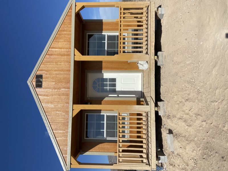

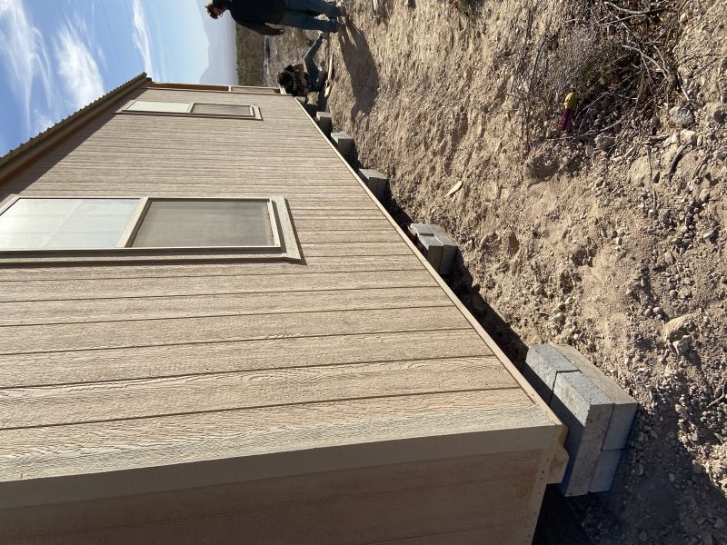

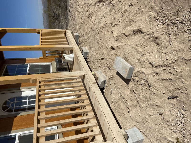

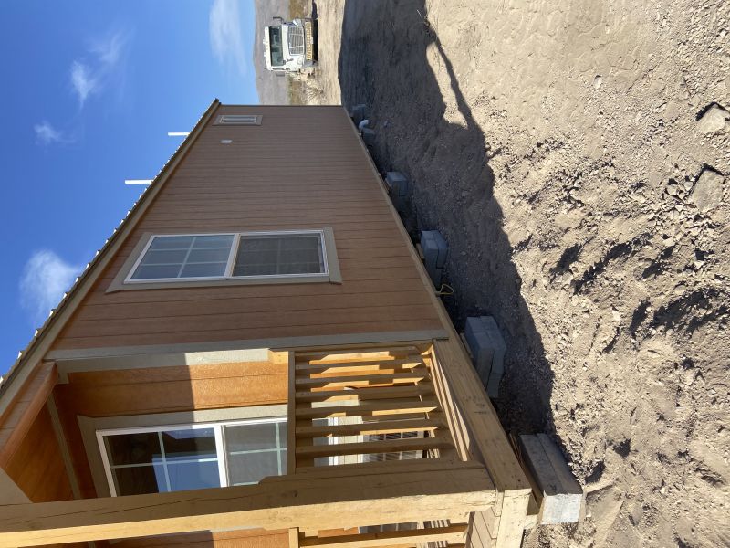

# Posted: 25 Oct 2020 04:18am - Edited by: deb9755
Hi my 16x32 cabin on 4 skids was put on a caliche pad with 4 16x8x4 blocks (placed side by side then 2 more the opposite direction on top) underneath. These blocks are not mortured but they’re spaced under all 4 skids every 5.3 ft. The skids are pressure treated

# Posted: 25 Oct 2020 07:57am
I’m wondering if there could be a long term issue putting blocks under skids because I’ve never read anyone doing this on here.

ratfink56
# Posted: 25 Oct 2020 08:15am
As long as moisture doesn't pool under the building you should be fine. I'm not sure how well caliche drains.

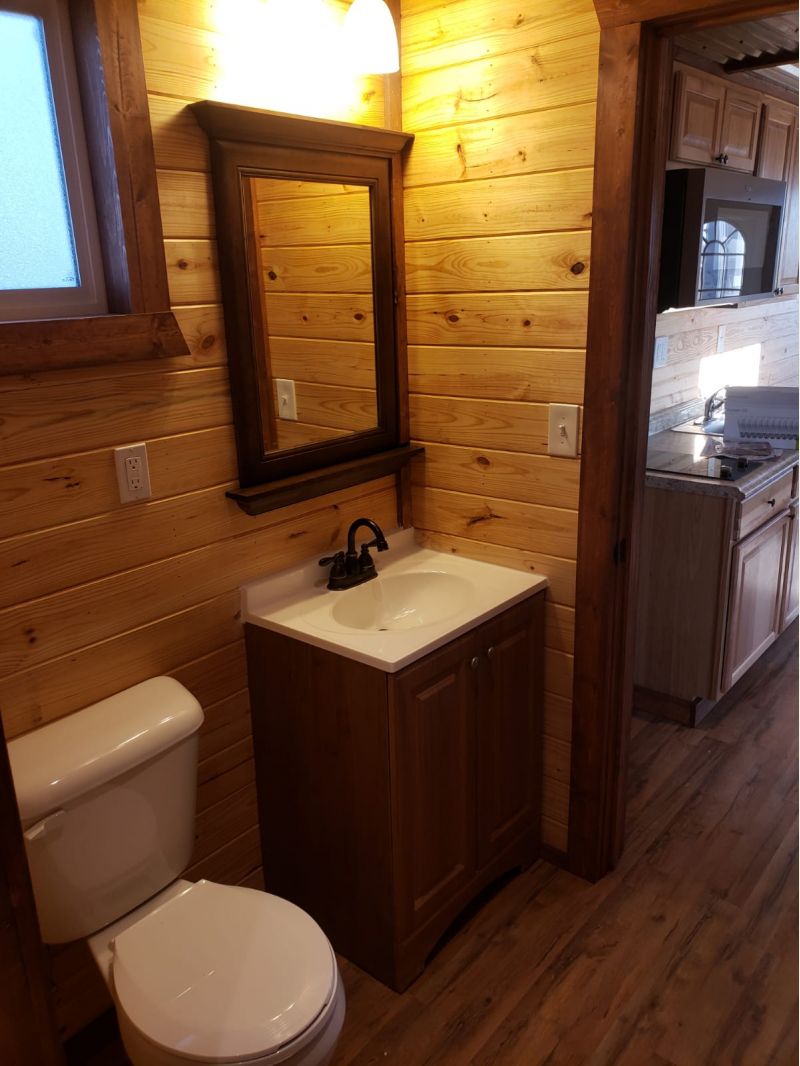

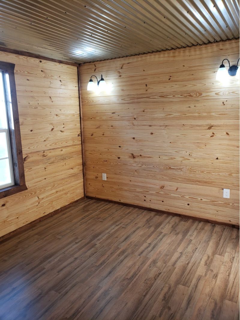

# Posted: 25 Oct 2020 08:20am

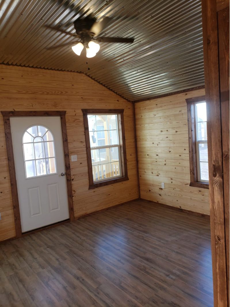

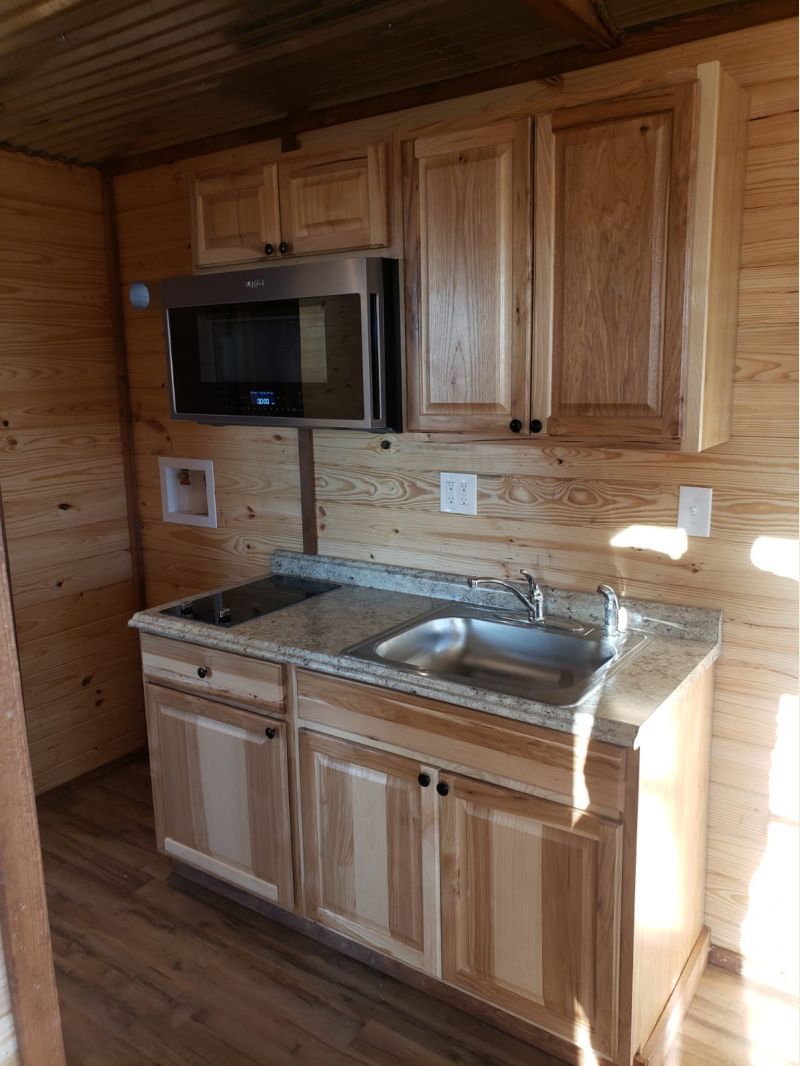

And since you said I was showing off I think I’ll show you the inside too lol

# Posted: 25 Oct 2020 08:36am
I did follow the suggestion from something on here to lay the blocks this way

# Posted: 25 Oct 2020 08:41am
The other thing that be never read on here is someone blocking a cabin without mortar and also so close to the ground. But they ran out of blocks so they opted to do space every 5 ft to compensate for what they said was a pad that hadn’t been tamped down.
