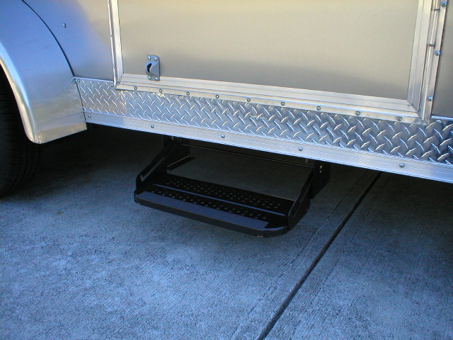

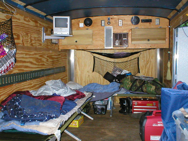

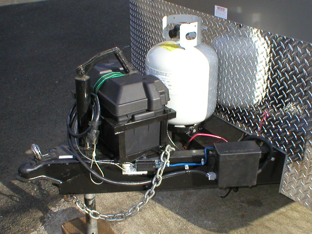

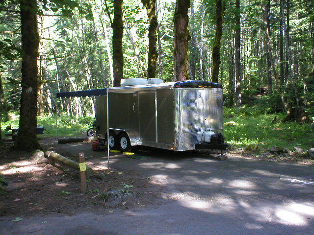

Will1IE, I did this, kinda. I used to go on lots of off road motorcycle rides and overnighters, so I made my cargo trailer suitable to sleep in. First, ordered it with a side RV door, I added an AC unit, a Suburban 20,000 BTU RV furnace, a charger/controller, stereo and reading lights. Its worked great. I did remove the AC unit, no longer use it for rides, added another roof vent where the AC was.
You will get sweat on the inside of the metal skin, when it beads up after heating the inside, you want it to run down and out the bottom of the walls. Packing in insulation will just soak up water. I didnt insulate mine, I did insulate the roof for the AC.
