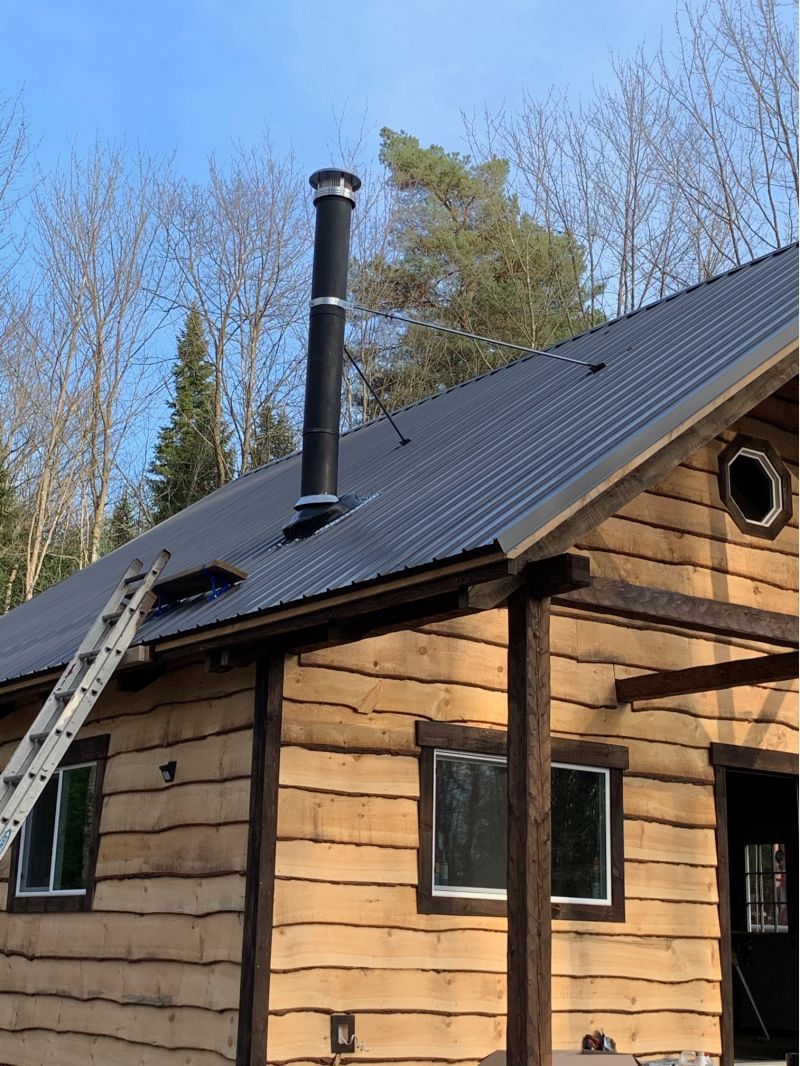

And here is a picture of these rubber boots in use
To confirm - that is a triple wall external pipe, sprayed with black high heat paint and it works perfectly

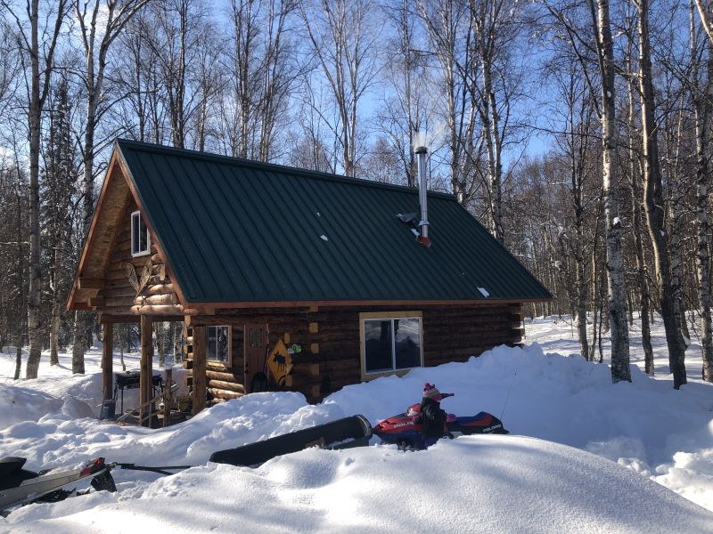

Here is my Class3 insulated pipe through ceiling, this is the only rubber boot I could find, kind of small for a 6" pipe on a 12:12 pitch. But it works. I have been meaning to get up there and spray paint the boot black or green, the orange is terrible looking.

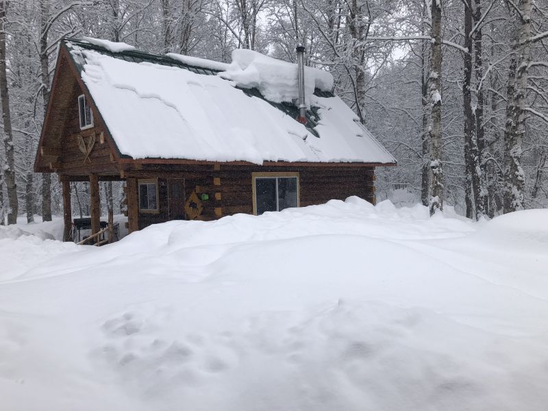

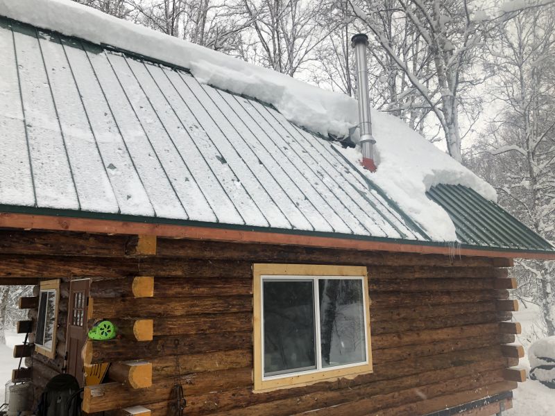

Wow fisher I’m surprised you have a chimney. I know because they stack on my roof got pulled over , again. On our home. And it’s only 5’ from the ridge. Metal bestus brand triple wall stainless steel. Metal roof 12/5 pitch. The ice n snow freeze around it and when it slides it takes it off. The roof is about 30’ long so I guess that’s just a lot of weight when it gets over a foot of compacted snow on the roof. I’m thinking I just need to put up snow brakes n not let it slide.
It is the stack for our central heating system a fuel oil forced air furnace. We haven’t used it since we put our pellet stove in and have a toyo in the upstairs level. We have 3 separate heating sources in our home. My job can take me away for months at a time so I can’t take chances. Near ten below this morning.

I installed a snow brake and pipe holder. It does a good job of keep the snow from taking the pipe out. I would have rather installed a cricket but didn't want to drill through the tin, I have standing seam roof. The snow brake is clamped to the standing seam ridges. We got a few more feet of snow and I went up on the ladder and shoveled the snow off around the pipe. I don't seeing having to do that very often.
