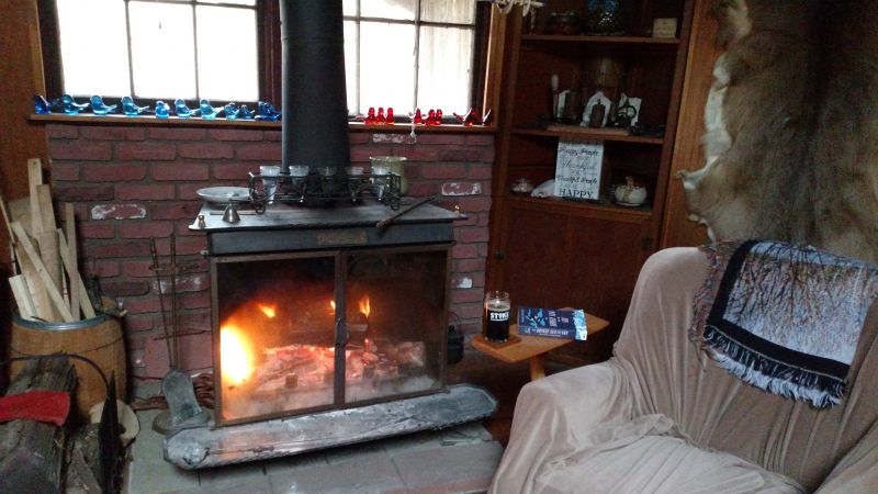

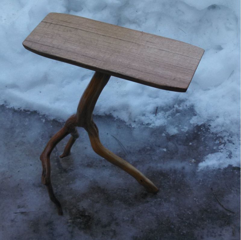

This is a small table that sits next to my chair by the fire, just big enough for a book and a drink. The oak slab was from a big old tree that fell across my front path, and the laurel legs came from nearby as well. The top is shellac and satin laquer, while the legs are shellac only. IMG_20140227_172421_.jpg

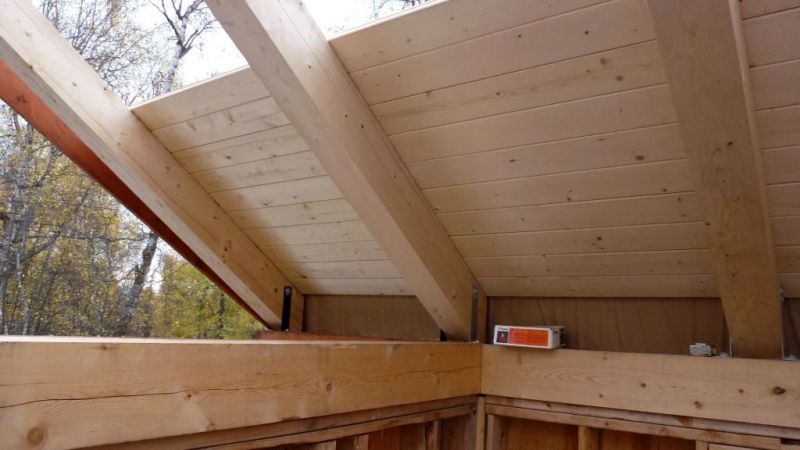

# Posted: 6 Nov 2020 04:16pm
In this photo, the timbers have Varnathane on them and the T&G decking does not (at least not yet). The color looks the same to me. This is white spruce wood.
