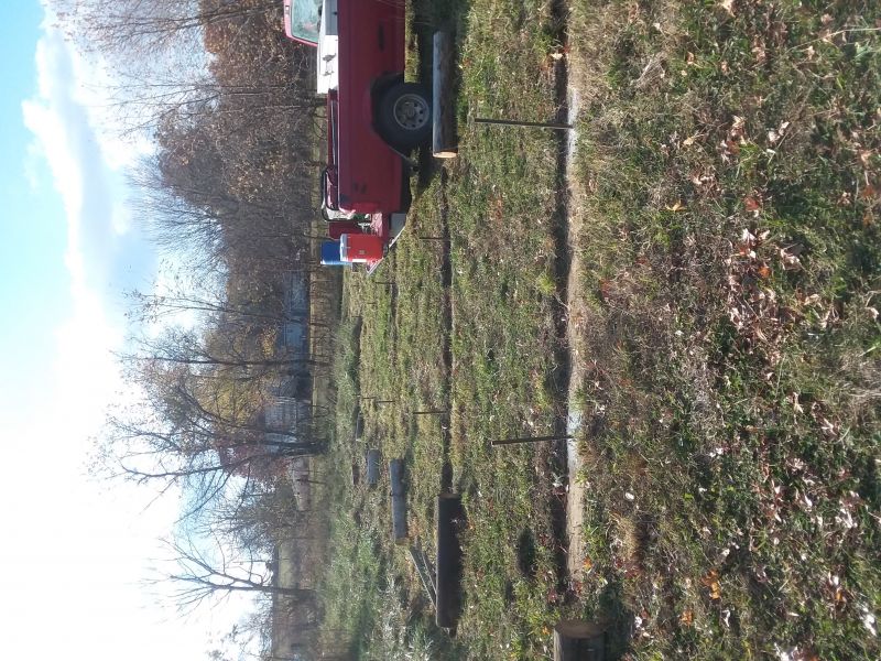

So this 1.25 a.c. plot had a trailer on it and had the 6 raft concrete footings installed back in 1990. The plan originally before I knew of the footings(covered in grass) was to use some beefy used electric poles as piers .

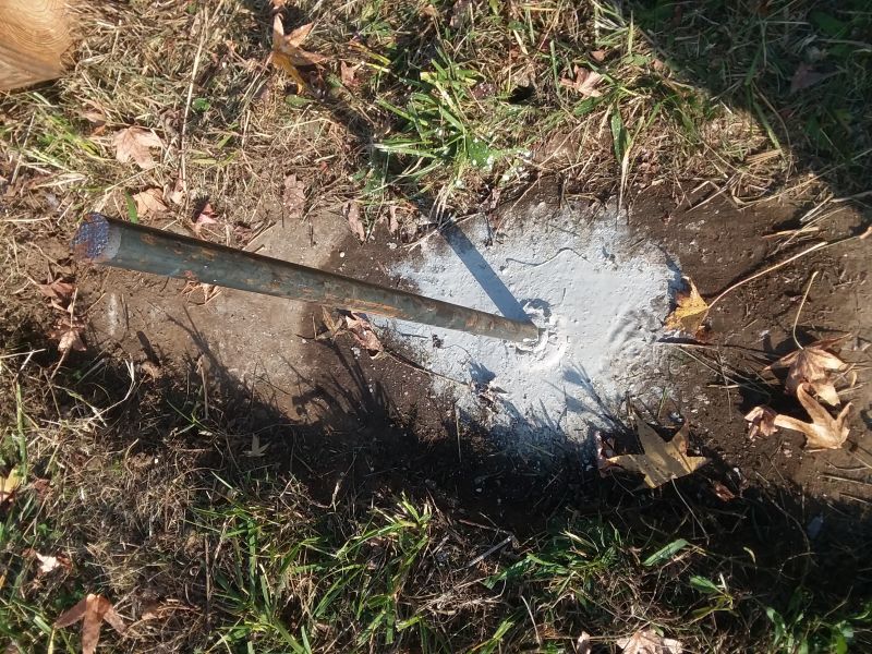

I still used the posts but instead of digging holes and pouring concrete I decided to drill 1" holes in the bottom of the post and the footing and pinned them into the footings with 1" solid rod.

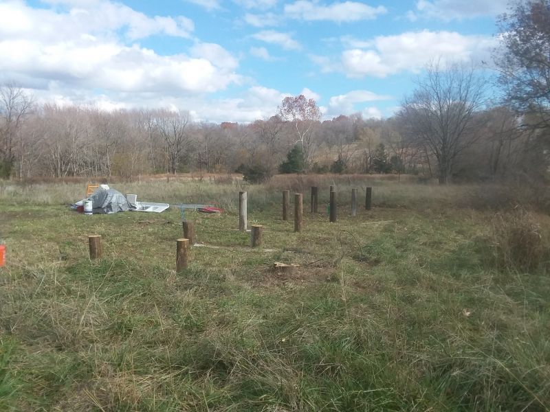

the pics shows some posts out of plumb, but I plumbed them after the pic. I set the posts to stay about 3/4" above the concrete.
I was wondering about a couple things. I was sort of thinking to pour a mix of mortar under the posts by lifting them and setting them back down this would shim the posts and keep them off the moisture of the footings.

the cabin piers are set 6 ft apart and that means I'll have 2 foot overhang on each side, splitting the span so to speak.
could I be oak with just fitting in one 2x12 across each pair of piers? or should I use two on each side of the posts? the plan for the building is to frame it in as post and beam, or stick frame depending on materials at hand.

Imo, the mortar idea is a no; it wont stand up to the load or prevent a potential moisture problem into the posts and once it starts to crumble you will be sorry. Fwiw, on my projects using posts from 30ish years ago I coated the end grain and sides with two coats of that 'blackjack' roofing patch goo, they are all still doing well. Perhaps something like a chunk of some heavy duty industrial plastic between wood and concrete would work? Dont scrimp or compromise on the stuff at the bottom end of a build, that is what everything else sits on.
