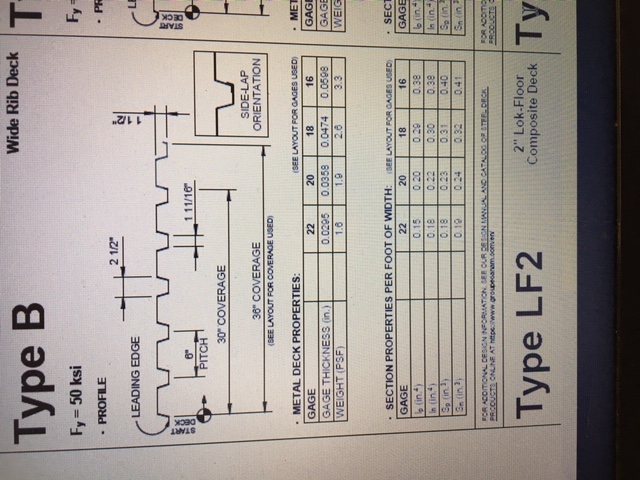

Hello All,
As a commercial contractor I come across lots of left over/ over ordered materials with that said I have bunch of 22 gauge commercial roof decking and was wondering if that could be wiped down with mineral spirits or something and painted and used as a roof?

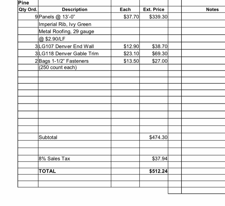

# Posted: 13 Nov 2020 06:27am
Quoting: Brettny
Galvalume metal roofing @29 gauge is $1.5 per sqft. Any good coating may cost a few bucks too not including labor and prep for a product that's not made to do what your trying to do
It’s even cheaper than that. Here is the invoice for the roofing on my lean to
# Posted: 13 Nov 2020 10:10am
The colored stuff is more but I quoted square foot.

Srollins
# Posted: 16 Nov 2020 10:27am
I believe the material has a pre installation oil type coating , which can be wiped down with something i'm sure.
