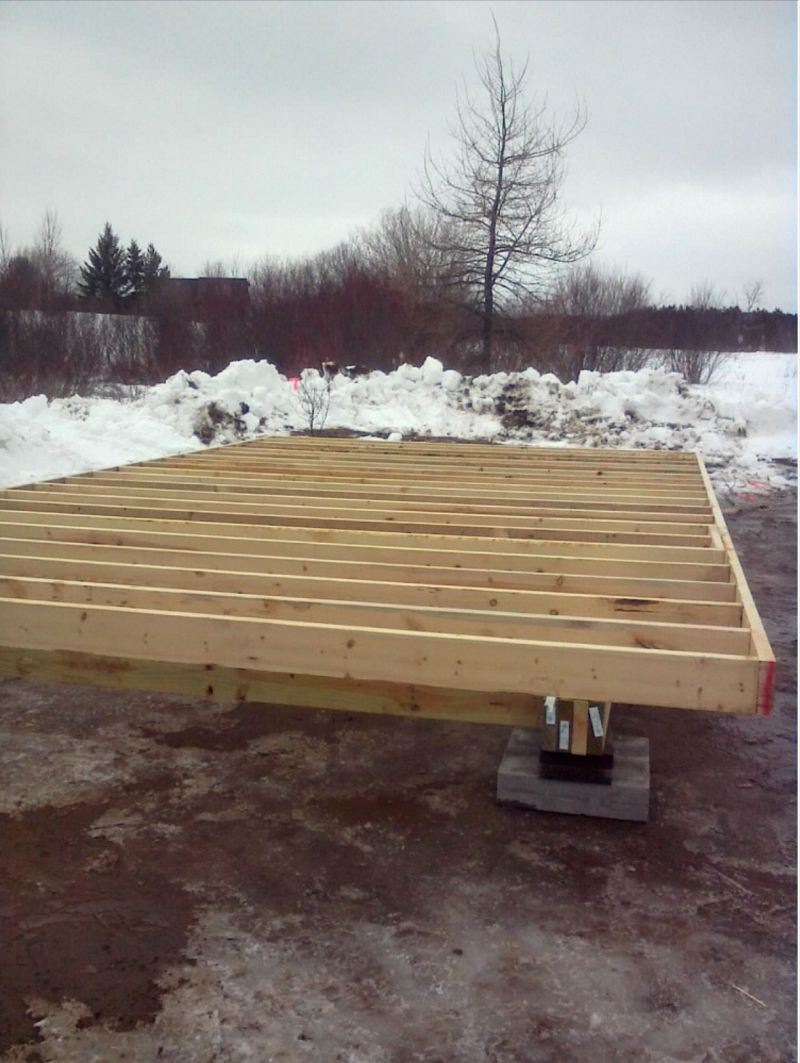

# Posted: 15 Nov 2020 04:07pm
Here's a photo of essentially what I had in mind for a foundation, though I don't think I need it this beefy for the small cabin I have in mind. From a poster on this forum named Owen Christensen.
Skid Foundation
Skid Foundation

That is your typical shed foundation. I wouldnt mother with laminating PT for the skids and just use 6x6 for runners. As for how to insulate the floor foam is best, not sure you need 4in of foam though. You can build the floor and walls like normal then lay down foam ontop of your sub floor and go from there.

For skids, my thinking was that laminated 2x6es would be less likely to warp and twist over time compared to 6x6es, and not a big deal to make. Could make whatever length I want. Might want to extend them out for a small porch.

Last I heard on 6x6 beam cost was pretty big bucks and yes, I too think lam planks would be more stable. Thing is, are either really necessary?

I think the rationale is if you omit a center skid you should go extra beefy on the two skids and the joists. I’m not sure what is “enough” for a 10x14 cabin (leaving an 8-foot joist span with the skids in one foot on the perimeter.)
